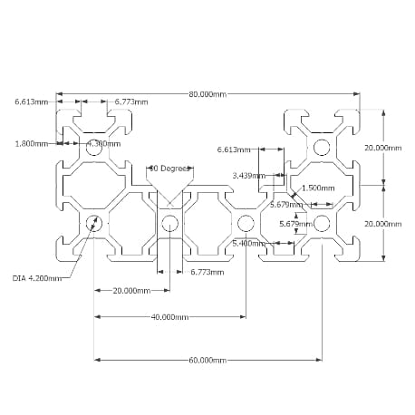

    Space from center to center of the v-wheel bolt = 99,65mm (this time i've measured z-plate, as i'm assembling it now)
    Complete v-wheel diameter = 23,95mm
    C-Beam height = 80mm( in the side where is that ACME nut-blocks space), and 79,85mm on the whole-alluminum side, which is bottom in the picture below)
    C-Beam width = 40mm
    Well, dimensions of the C-Beam are probably the same as shown on the picture below (checked some of them and everything looks ok):
    I've used mechanical calipers so i't can be a little wrong. Will have electronic one's in about an hour.
    But on the paper and when measuring, everything looks ok.
    If I will assume that my measurement about right:
    beam height + 2 x wheel radius - 2x wheel recess on the C-Beam for the wheel = Space between 2 bolts
    80mm + (2 x 11,975mm) - 2 x 1,8mm = 100,35mm (space needed for wheels and c-beam)
    So 0,35mm more than the distance between the centers of 2 wheel bolts. Of course it's true if accentric nut is in the center position. Accentric spacer can go max 0.79mm of the center (am i right?) So if i will twist it to the most wide position it should be OK.
    That was the math (my math skills are not good :p )
    And in reality I will just need to have accentric's in the most wide position and leave it that way.

    Actually did a litte mistake...on the bottom i assumed i have 100mm of clearance and i've measured 99,65mm between 2 bolt centers.
  9. Alex Chambers
    2,760
    1,352
    I think your maths is right - if you are still having problems check with @Ryan Lock at Ooznest that the plates and C-beam are within tolerance.
