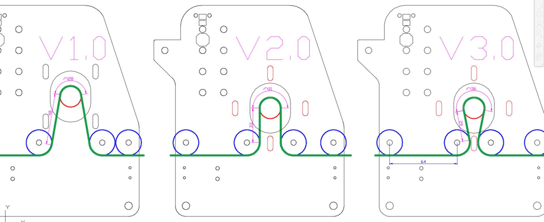

    Hello!
    I assembled a similar machine. The first thing that catches your eye is the non-rigidity of the belt drive if you shake the carriage by hand. I did it like in v1.0 from the attached picture. When cutting out a circle, it makes an oval with a difference in minimum and maximum diameter of about 0.5 mm.
    How much do you think the error can be reduced by increasing the length of the arc around the pulley and reducing the free length of the belt in v3.0 from the attached picture?
  16. Rick 2.0
    2,887
    1,543
    The issue here is belt stretch. The examples you have shown help reduce the probability of jumping teeth but don’t do anything about belt stretch. Do a forum search for dual belts and you will find a plethora of information on how to reduce belt stretch.
  17. blacksabbrath
    Aug 8, 2022
    Thanks for the good advice, but I'm already using a double belt. Result on video: https://youtube.com/shorts/6r4GHNLfxGg?si=Mh_W9-BztZEO9dMp
    Just to reduce the length of the free belt, I depicted v.3.0. Compared to v.1.0, the length of the belt has been reduced by more than 1.5 times.
    The only thing that confuses me is that everyone uses v.1.0 in the construction of their machines, not v.3.0. WHY?
  18. Peter Van Der Walt
    14,571
    4,230
    Only one extra tooth of engagement? Correct positioning doesn't get much better the more teeth are engaged.
  19. blacksabbrath
    Aug 8, 2022
    In v1.0, the belt covers the pulley by 28mm, and in v3.0 by 36mm, this is a difference of at least 3 belt teeth and that’s quite a lot. In general, the belt should fit the pulley fairly well, so this is not the main purpose of the upgrade. I think the free length of the belt from the wheel to the pulley is more critical here, and only the lower engine mounting screw does not allow me to reduce it in version 3.0.
  20. Peter Van Der Walt
    14,571
    4,230
    At some point its worth admitting that belt will only ever be "as good" and selling off the machine for a better machine like a LEAD would be a good idea.
  21. Misterg
    Misterg Veteran
    Aug 27, 2022
    327
    252
    If you're concerned about belt stretch, then it's the total length of the belt that's important - You will need a slightly longer belt (=slightly more stretch) to use V3 compared to V1.
    I don't run a belt driven machine, but looking at your video, I think you could increase the belt tension.
  22. Rick 2.0
    2,887
    1,543
    I watched the video. Move the motor up and take the slack out of the belt.
