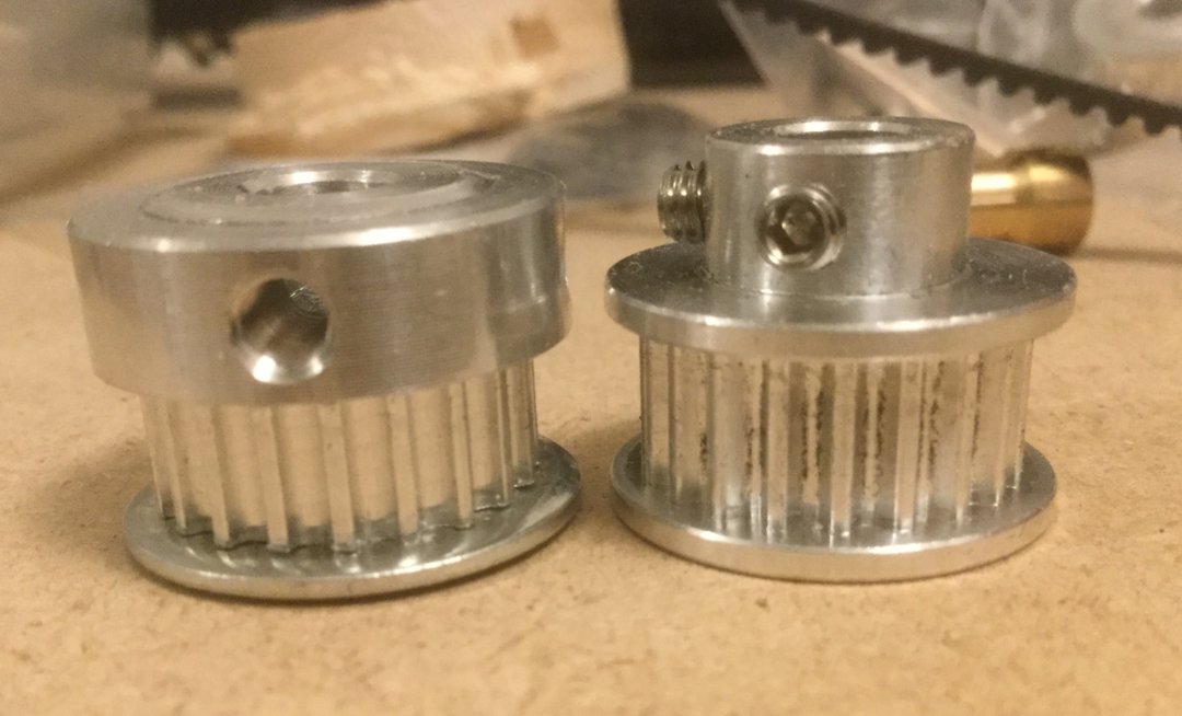

    Check the current on the X and Y axis drivers... bump them up a bit.
    Also, and this is something that got me... check the grub screws are tight as they are easy to strip. I ended up getting new pulleys with larger grub screws and incidentally found that the Ooznest ones were the wrong profile (ie were not actually for GT3).
    ..............(Replacement Pulley - - - - - - - - - - - - - - - - Oozenest Pulley)
    If you got yours from Ooznest you may want to check you have the right ones too.

    @NeoMorph i believe I have the same Ooznest pulley. Can you explain the difference. Would it be worth my while to change out?

    If buying new pulleys. Get the 16 tooth pulley for 20% more force and resolution. Found mine on eBay.. from seller Powge
    You can replace the grubs with m3 bolts, easier to tighten. Also use some blue locktite

    The Ooznest pulley is angular, more like a V than a U. As the belt teeth are U shaped it means you have to overtighten the belt to force the teeth into the pulley gears. This adds friction and you can see rubber being rubbed off into the bottom of the gears.

    Forgot to mention... m4 grub screws in mine... 2 in each hole. First grub screw locks the pulley to the shaft and the 2nd grub locks the first in place. Works even better than M3 bolts.

    While I’m not an experienced CNC wizard I actually AM an experienced modder and I tend to look for reasons when the machine just doesn’t sound right... and I’m still trying to find the reason why the dual axis sounds crusty as hell on Ooznest machines because I would love to help those guys after being so good to deal with.
    In fact, when I contacted Ryan Lock about it he sent me an email back about the pulley problem....
    Most directors would woffle on about it being an alternative or more efficient one... but Ryan just admits they missed it as it comes from suppliers (in sealed bags no less) so it looks like they were sent the wrong pulleys.
    I prefer the thicker pulleys because they are better in numerous ways.
    • Right profile.
    • Narrower channel to stop wandering of the belt.
    • Stronger construction.
    • Ability to use larger and multiple grub screws. (I think the original grub screws are m2 or m3... I replaced mine with m4 in the dual configuration.
    • Better machining - the new ones are from Powge and look great. Hardly any machining marks while the Openbuilds ones while ok if you use a matching belt are just not GT3 pulleys. Just run an Ooznest one through some modelling clay like Plasticine or even Blu-Tac and you will see the profile is chopped off little pyramids from the side while GT3 is a half moon.
    I think the pulley supplier is the one at fault due to the pulleys being supplied in sealed bags. I hope Ryan gets it sorted because I bet this is the problem with Ooznest pulleys sometimes skipping teeth... and if the pulley supplier is sending out the same pulleys to other Ox and C-beam machine makers... well it would explain why we have to double belt.

    Not sure why you have 4.5mm I thought 6mm belt was standard.
    The pulley can be wider than the belt you never want the belt rubbing on the retaining walls anyway, it will cause wear.
    I know you were not asking me but these are the ones i use and they work great with the real GT3 belt from Powge ebay link ship from china

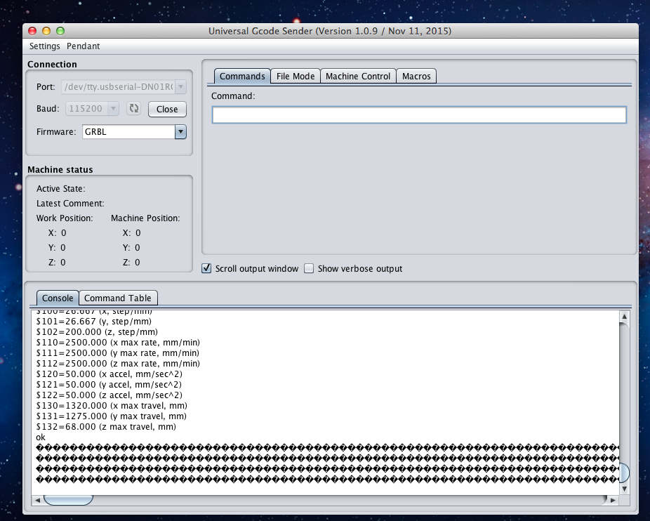

  30. MplsArtist
    Apr 11, 2015
    41
    My 1500x1500 OOZnest has been working great for the past 6 months. Today, a weird little gremlin popped up on my Universal Gcode Sender screen. When I open up the command window, I get many lines of non-stop, repeating question marks. I've tried rebooting the software, rebooting the computer, disconnecting and reconnecting the USB cable from the computer to the Xpro board, resetting the commands and re-entering all the settings as indicated in the OOZnest manual. I also dumped the UGS and reloaded it on my computer but I still get the repeating lines of question marks. They stop repeating as soon as I close the commands tab on UGS.
    I opened up the machine controls tab and entered 10 mm x,y, and z movements and they seem to operate the gantry controls properly, but I'm hesitant to do any cutting with this gremlin lurking around in my machine. I've attached a screen capture. Any suggestions would be greatly appreciated.
