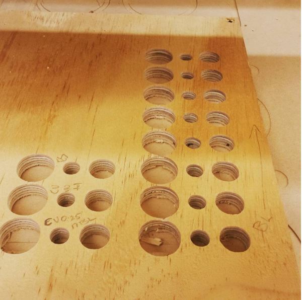

    Jetsah
    Could you post a pic of what settings you have in general config on mach 3. Still getting some "wavy" issues!!
    Is distance mode IJ mode an issue ?

    Could you please expand on what you mean by wavy? In the cut, in the machine movement, cut shapes off size from expected/programmed?
    I have attached an image with the key points marked.
    General Config
    Motion mode - CV
    CV Control - All off
    Now push your machine acceleration till you lose steps or it becomes unstable and back off 20%. Do a test cut to make sure your happy and not losing steps under load and your done.
    You may end up trying Stop CV on angles (read up on this as I remember last time I played with this I found it behaves backward to how it reads but this MAY be an issue with the smooth stepper in the system)
    Then if you need you can try using CV dist Tolerance but I find this makes for some jumpy machine moves and have not had much luck with it. Avoid plasma and G100 modes unless you know why you need them ;)
    I would also stock up on toads eyes, raven feathers, sacrificial chickens and/or goats as tuning CV can feel like black magic with mach3.
    @Ryan Turner thanks for the tips on the CA, I don't think my workshop gets cold enough to worry about it letting to... if it did I would be giving up working as well! I was more worried about the overall height making the engagement of the two belts too lose.
    Marcus1 likes this.

    Jestah
    Many thanks - I will try your settings. I am no good at Black Magic and there are to many variables, I need to cut down on what systems are causing errors.
    Do you mean acceleration or speed?

    @Marcus1 Before you go smashing into real work take some time out to do a test pattern. For CV tuning I start with a hole 2D, 4D, 50mm and 100mm and no CV check boxes and low acceleration (don't worry about motor speed as in small holes with sub 5mm bits you won't get any where near it)
    Cut it and try and see if you have any mechanical backlash and where it is coming from. Change ONE thing and then recut the SAME gcode. I usually start my pushing my feed up to the tool sounds good then start increasing my acceleration settings to the point it starts showing up as flaws in the cut. I will note each change with pen and then get a clear idea exacty what is working and what is not. as a tip you can set your post/cam to leave the cutter head at the part furthers from 0 corner so when it finishes you can just zero out the axis DRO in mach3, make your one change in the settings then regen and cycle start.
    This is us tuning in our latest build with double belts, 2mm per pass, 3.5m/min roughing 1.5m/min finish with a 6mm tool. Having the "history" of your cuts really helped us get more of a gut feel where out issues actually were too!
    The other thing to know is that small flaws like what your seeing COULD also be the stock lifting up or moving a very small amount. With hobby style machines you need to think a little more carefully about your lead in/out to try avoid chances of little nicks like your getting. I usually rough out a part in step down passes using ramp-s with 0.5-1mm left on the part then do a last clean up profile on the target size using an arc lead in, over cut and arc lead out to hide any small hiccups you can get on start points.
    Ryan Lock likes this.

    Jestah
    All very good advice - Thanks
    I am roughing out and then finishing this with a 1 mm finish pass. Leading in I am using angles 30deg plunge. Arc lead in seems to nick the top edge. Using Vetric do you know how I lead out. I cannot find how to do this.

    The top could be marked if your spindle is not trammed so the tool is tipped over in the finish but also this can be caused by even the smallest belt stretch issues too. Arc in and outs are nift when you don't want to see that ramp angle on the finish cut but are harder for a machine cope with.
    The lead out is under the lead options as a tick box that says "do lead out" and overcut distance.

    @Marcus1 start by making sure you have no backlash. From your photos your very small wobbles look like they could be belt stretch or movement. The smallest backlash will show up in any finish cut as they are only as good as the weakest link in your drive train.
    also try leaving a shallower finish pass to help ease up on your cutter loading and see if this helps. Also leave your parts tabbed in for the full cut. Use a table router with a bearing follower bit to clean them up super fast but keeping your stock solid up to the end is just as important as having no backlash. You could also try a cut that has much lower feed (reduce your RPM as well to maintain good chiploads) and see if this helps your issue.
    The method I suggested before is how I run my arc in and outs but it took a lot of sorting of the belts to lower my backlash enough that it didn't show up in my finish passes noticeable. The other thing to remember is that these are hobby machines, amazing value and a very low cost way to learn CNC but it is fair to ease up on the expectation that they give perfect results. My Ox cuts like a dream but it has taken me a long time of tuning and also easing up on my cutting methods as compared to the cutting style I ran when programming for a commercial cut shop on a one tonne router pushing around 13KW of spindle.
    So to recap.... Check your spindle is nicely trammed, reduce as much backlash as possible and make sure to be taking a very light and slow finish pass that eases the cuter into and out of the cut.

    Getting better results now thanks to your advice. Circles are nearly there, just a slight over cut in X on both sides. Hopefully this will be solved by gluing down the bottom belt when I have some time. Still cannot think of a decent cutting strategy including an arc lead in/out that does not disturb the loose part as it is impractical to use a table router for clean out as most parts contain hundreds of them!
    I resurfaced the spoilboard and the tramming is indeed out slightly, but surprisingly its not out in the plane looking directly at the spindle head on, its in the plane looking sideways at the spindle, suggesting that the X beam is not vertical.

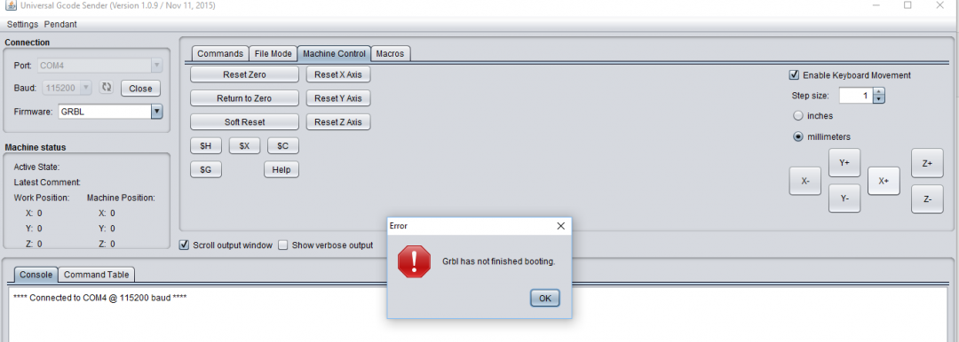

    I am looking for some help.
    I have bought the OX cnc and i am having difficulty in connecting it to my laptop.
    i have downloaded the universal G code sender v1.0.9 and the windows driver from ftdichip.com/drivers/vcp.htm. Baud rate set to 115200 and firmware is set to GRBL, but i only get the message "grbl has not finished booting". I can normally sort most things out, but this has got me stumped. can you offer any advice.
    thanks

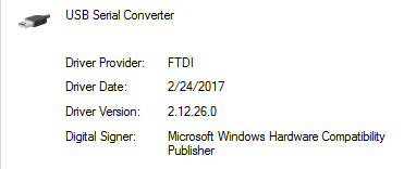

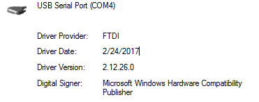

  22. andrew openshaw
    May 1, 2017
    Hi Ryan,
    Still no luck, tried both the 1.0.9 UGS build and the 2.0, both with the same result.
    I have deleted and reinstalled the ftdichip drivers, this has not helped either.
    Tried it on a second and third laptop, and changed the USB cable, still no joy.
    anymore thoughts?
    Andrew
    Just read one of the reviews of the controller board from your website, and it says "I have followed the instructions to protect the 12v input with a TVS Diode as I suspect a back-EMF surge did for my previous board. Recommended". Which diode is this? and should i have fitted it?
    Andrew
    #742 andrew openshaw, Jul 2, 2017

    Hi Andrew,
    Ok, is the board getting recognized windows? Do you want to try one more thing, re-flashing GRBL 1.1 to the board:
    3. Updating GRBL Firmware · Spark-Concepts/xPRO Wiki · GitHub
    If this fails, i will get a new board sent out.
    With the new V3's which i think you have, they have extra protection, so this diode isn't needed.
    Ryan
