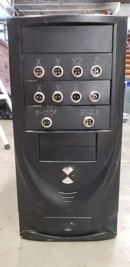

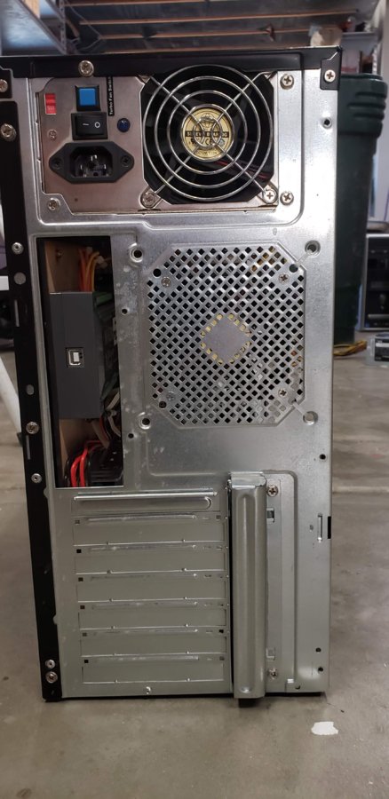

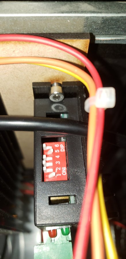

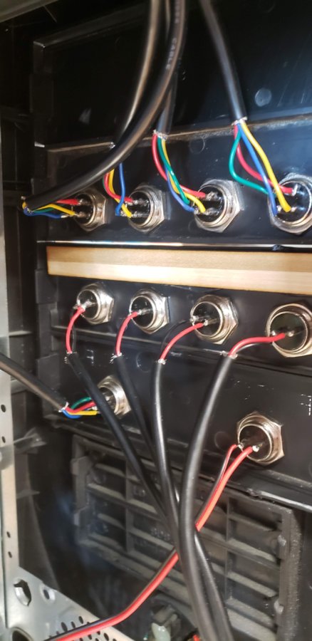

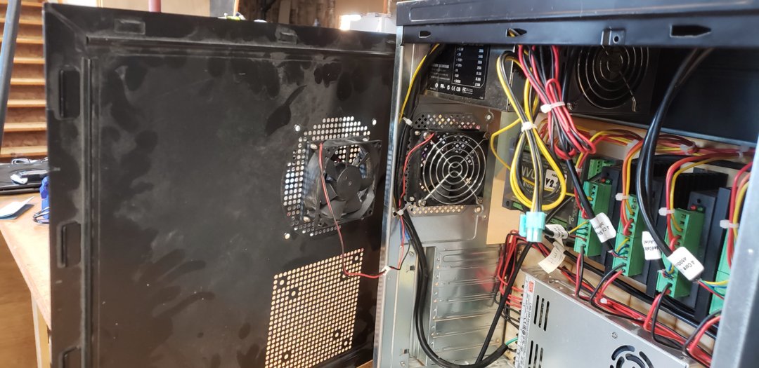

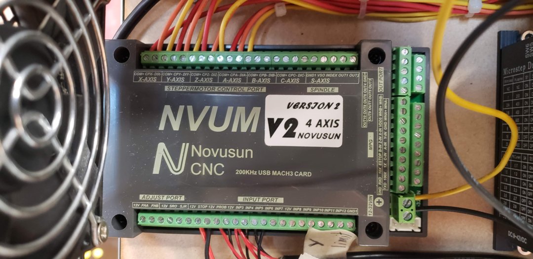

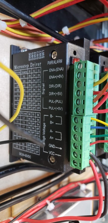

    This is intended as a roadmap for those using the Novusun CNC Controller and TB6600 Stepper Drivers in their CNC project. It should help you in component layout, power supply selection, and enclosure selection.
