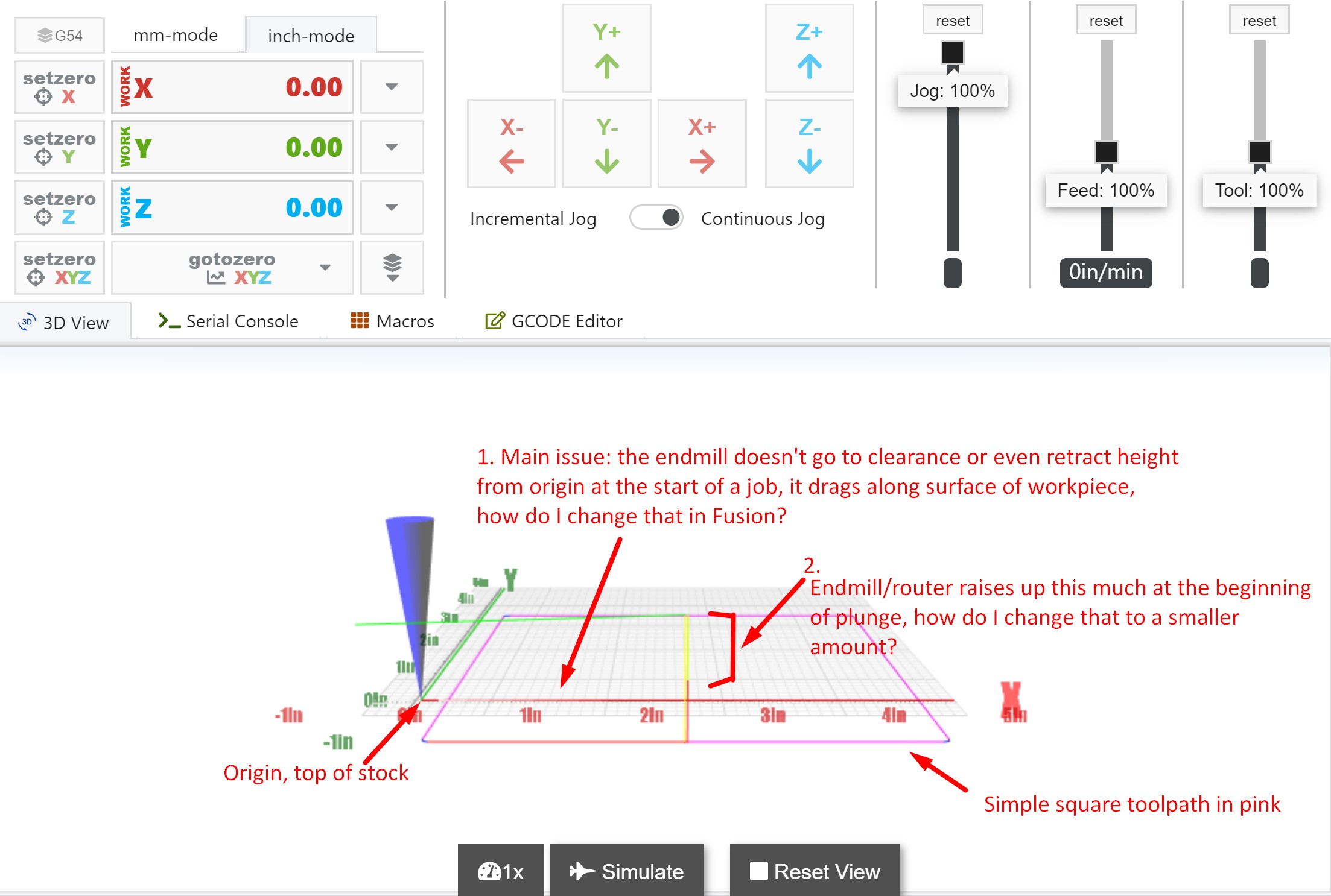

Not going to clearance height at start
Discussion in 'CAM' started by Mason Dixon, Jul 31, 2022.
  1. Mason Dixon
    Apr 19, 2018
    Hi, here are the issues that I'm having. Using Fusion 360 with OB post, 1515 lead cnc with blackbox
  2. sharmstr
    2,030
    1,428
    Make sure you've homed your machine. After that, make sure you've set your Z0 to the the top of the stock and not the spoilboard. According to your gcode, the first move should move to .3937" below the highest your machine can go in Z. If it doesnt, then you forgot to home your machine or your motor steps are way off.
