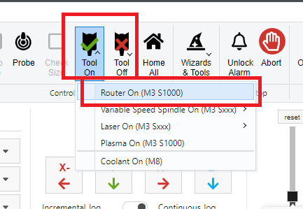

    Spindle control is under the Tool On/off menu:

    The Spindle won't respond and I just took the power supply and it only responded once I shorted it out. I was only getting .5 volts showing and now I am getting 24V. Does the Fan run all the time or only when it is under Load? And is there a listing for the Router11 as I am not seeing it?

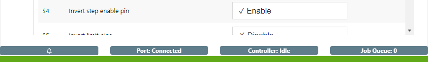

    $4=1 (Enabled) set?

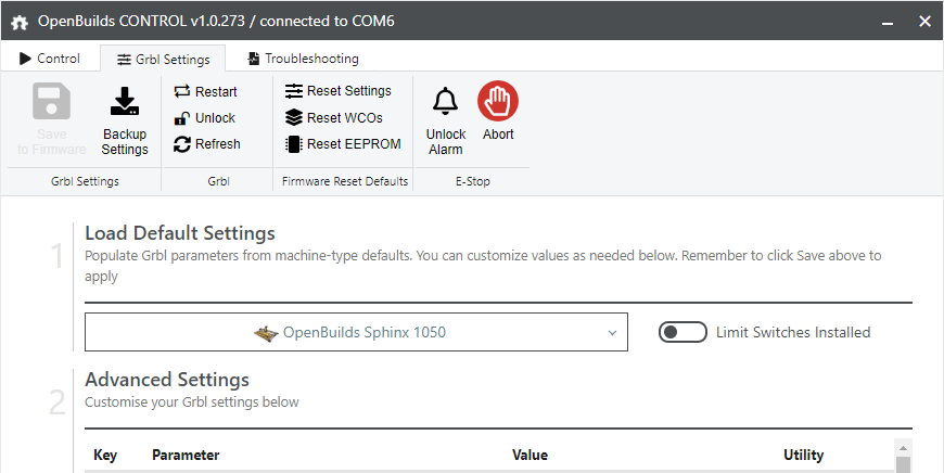

    THE GRBL settings that you are describing are not like anything that is showing when I go into the GRBL Settings Tab. There is No Option to set $4 =1 anywhere, at most I get an option to Invert the Signal such as if I look at $0=10us or $1=255ms and like $3= (0) X=0, Y=0, Z=0. $4=Invert.
  8. David the swarfer
    3,277
    1,835

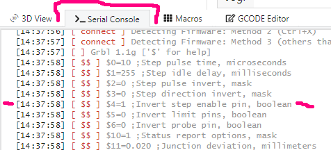

    In the Serial Console you see all GRBL settings in a 'raw' form
    In the GRBL Settings tab you see the human friendly display of the same stuff....
    so $4=0 means 'invert step enable pin is disabled' = enable is not inverted
    and $4=1 means the invert is enabled. Blackbox requires this to enable the drivers.
    You should read the GRBL Wiki about the settings, this will enable you to understand the settings page and get your machine working.

    I have 24V output from the power supply, Home Switches are working and when I click on Connect it is showing FTDI USB Driver. When I try and move any axis the DRO's Move but Nothing is coming from any of the motors. and here is what I got from the Serial Tab.
    $0=10
    $1=255
    $2=0
    $3=6
    $4=1
