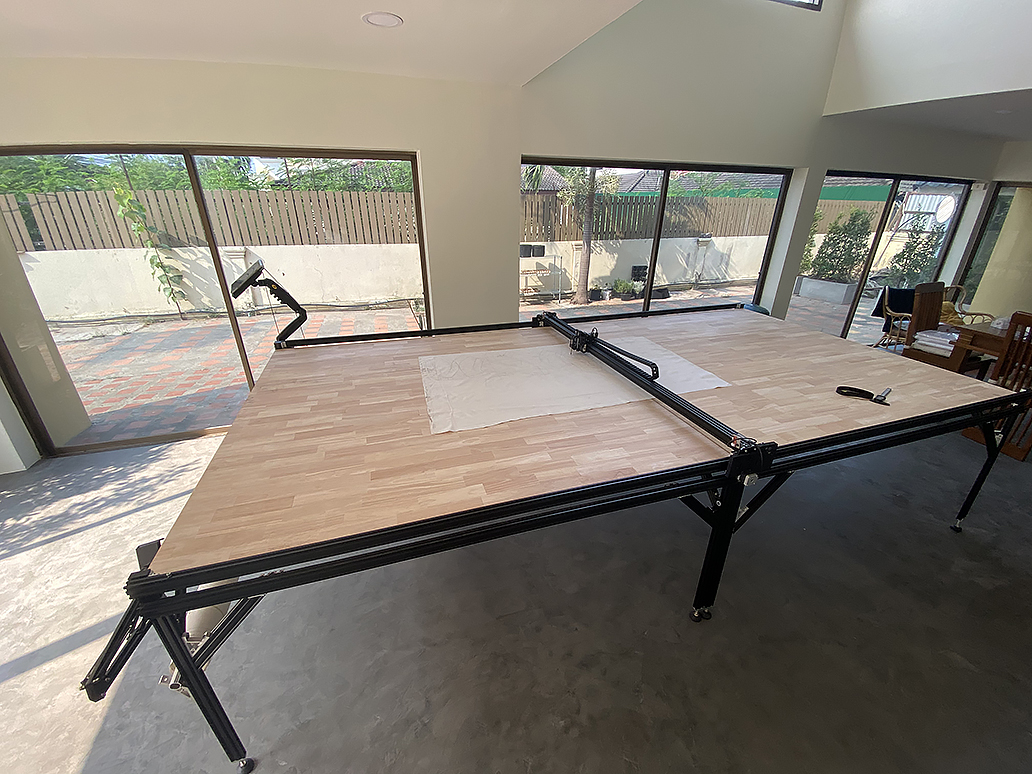

    Many months later I have a working plotter!
    However because of its large build volume 4m, x 1.8m, it's very hard to have the table to exactly the same height everywhere.
    This is easy to combat if I had a larger servo travel distance. @Peter Van Der Walt The Open-Builds software only allows me to “calibrate'' the servo about 30 degrees of rotation.
    Would it be possible to have the servo rotation go as far as 90 degrees? 2021-03-11 15.30.44.jpg
  13. Peter Van Der Walt
    14,871
    4,283
    You set the values, it can do 0-255 full 8bit range. The range should only be limited by your mechanics, or ordering the wrong servo (you get them in various ranges of what 0-255 does in real world, based on gearing in the servo. Full rotation, half rotation, and smaller increments too. Even continuous servos.
  14. Myosis
    Myosis New
    Oct 5, 2020
    19
    @Peter Van Der Walt I'm using a Using a Tower Pro 9g
    I've tried a Tower Pro MG995, but same results, only about 30 degrees of rotation
    Also tried a Tower Pro MG90S, but that doesn't seem to rotate at all.
    Is it because of the servos I use ?
  15. Peter Van Der Walt
    14,871
    4,283
    Probably. Get some good ones from a RC shop, they'll have better specs of the torque and swing angle etc

    It won’t do the rotation with the software as is.. But I did solve my problem by designing & printing a more efficient lifting mechanism. I now get more than a 1cm of lift with a 30 degree rotation.
    This is more than enough to level out uneven parts on the table top.
    If someone does know what the problem with the rotation might be, I would still love to know.
