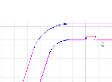

    Hi
    I am trying the whole chain of making a first project.
    I have managed to make the design under Fusion 360 and generate the GCode from it with GRBL post processor (thanks to explanations here).
    I was a bit confused with feed rate settings in Fusion but I think I managed it and now I am simulating the cutting into CONTROL software and I have something weird in the some parts of the cutting: the curved ones.
    I don't know why (I mean I see no reason in terms of speed setting) but in the simulation it is making the curve very fast contrary to straight lines.
    I am wondering if it is just a side effect of CONTROL having more difficulty to calculate curve or if what I see is really what I will get on my machine.
    I upload the GCODE file and the first curve where CONTROL is going very fast is the line:
    G2 X143.524 Y203.009 Z-10 I57.063 J-18.541 (line 47)
    Side question: it is not easy to find which line is doing what in CONTROL (may-be the number at the bottom right of the window is the solution but I could not find the link between this number and the line number in GCODE). So I end up using other software which was able to go line by line in the GCODE and show the resulting movement.

    Simulation is 'best effort' and will run fine on the machine itself.

    I'll see if I can add the "tweening" (the part the makes the sim "flow" from point to point, to the G2s it had trouble with
    14,749
    4,264
    v1.0.234 or later (not released yet) has some improvements to the SIM now :)
    - Follows the arcs with the set feedrate
    - Doesnt decelerate/accelerate to/from 0mm/min between sections (machine would also continue smoothly)
    - Added the gcode line indicator to follow the cone (was in there a while back, had a bug and wasn't showing)
    GIF showing it in action (on your test Lamps file)
