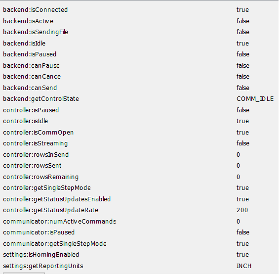

    Hello! I'm setting up my first GRBL on RAMPS / ATMegat2650. I have everything downloaded and can interact with the controller, but when I load up Universal Gcode Platform, it shows me a big, red "Alert". Furthermore, trying to execute a command to move X-axis motor fails. All that's happened with the controller is that it's booted up. Resetting results in the same thing.
    Here's the state of the controller. The UGS status is attached as an image.
    At this point, I'd like to determine the error code that's halting my progress. I can see there's an error from the big alert notice in UGP, but I've been unable to figure out what the error code is. Where do I look for that? Is there a GRBL log somewhere? A command that'll spit it out in the console? Thanks in advance!
    >>> $G
    [GC:G0 G54 G17 G21 G90 G94 M5 M9 T0 F0.0 S0]
    ok

    >>> X10
    [Error] An error was detected while sending 'X10': (error:9) G-code commands are locked out during alarm or jog state. Streaming has been paused.
    [Error] Error while processing response <An error was detected while sending 'X10': (error:9) G-code commands are locked out during alarm or jog state. Streaming has been paused.>

    Send a $X to unlock and $H to home. Grbl expects you to Unlock and Home on startup.
    dlamet likes this.
  3. dlamet
    dlamet New
    May 4, 2021
    That worked great. Thank you!
