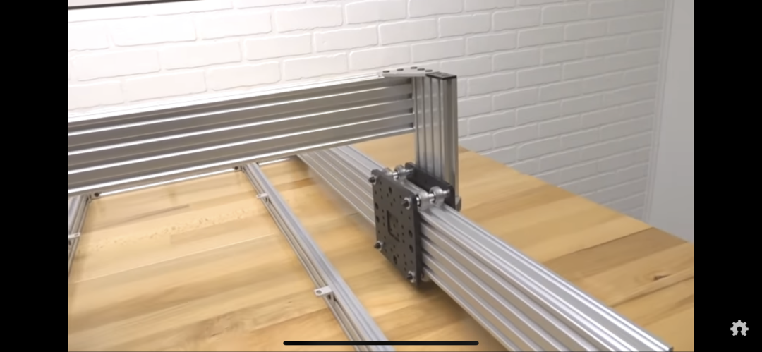

    I think option B, modifying it with something like this but I don't have much room for that massive joint between the X and Y axis. Is there a place to find the different Openbuilds parts to start laying out some plans on Fusion 360 pls?
  3. GreenCampuLtd
    Jan 31, 2022
    26
    The longer axis (Y) rails are not C beam, they are square which would save space, so would the metal plates that fit the X to the Y axi. I could do them on the inside of the Y rails so this XY gantry could fit into the Dowell frame. I will come up with a drawing of that.
    OpenBuilds Workbee 1050 (40" x 20")
  4. GreenCampuLtd
    Jan 31, 2022
    26
    This is more like it:

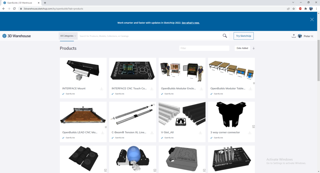

    Dear Peter,
    The sales team tell me that the Sphynx and Workbee kits are no longer being sold although they are available for sale on the website which is confusing. These kits have all I need already set out so it would be great to just use the BOM from these kits for a 1500 1500 c beam X-Y gantry rather than having to do it all again.
    Also the repository you directed me to was empty: OpenBuilds | 3D Warehouse
    Do you have any Autodeskfusion 360 compatable files please?
    Perhaps you could host your repository on: PARTcommunity 2D/3D Models
    Many thanks
    Charles

  8. Peter Van Der Walt
    13,749
    4,070
    Works for me, try again
    Yes, see Transmission - Lead Screws & Nut Blocks - OpenBuilds Part Store and Linear Rail
    Fusion opens Sketchup Files - we haven't ported the complete library but some are available here too OpenBuilds® | CAD Models | GrabCAD
    Yes, but your request contains some requests that cannot be delivered upon, thus the feedback. You wanted some 1900mm Actuators, etc for example. Our leadscrews are only available up to 1540mm (for our 1500mm actuators) so they cannot provide pricing to you as those lengths are not an option - we don't even have longer lengths in stock.
    You also don't really want to exceed 1500mm: How to calculate V-Slot® deflection along with leadscrew whip. For 1500mm you'd also have to use the Tensioning system or the leadscrew whip will be unbearable: See C-Beam® Tension XL Linear Actuator Bundle
    There are design constrains you have to consider. If you need a machine, order the machine. If you want to have custom sizes and lengths, and removing axes, etc - use the store to add the seperate components to your cart. Its a modular build system, you can order individual components, single axis actuators, or complete machines

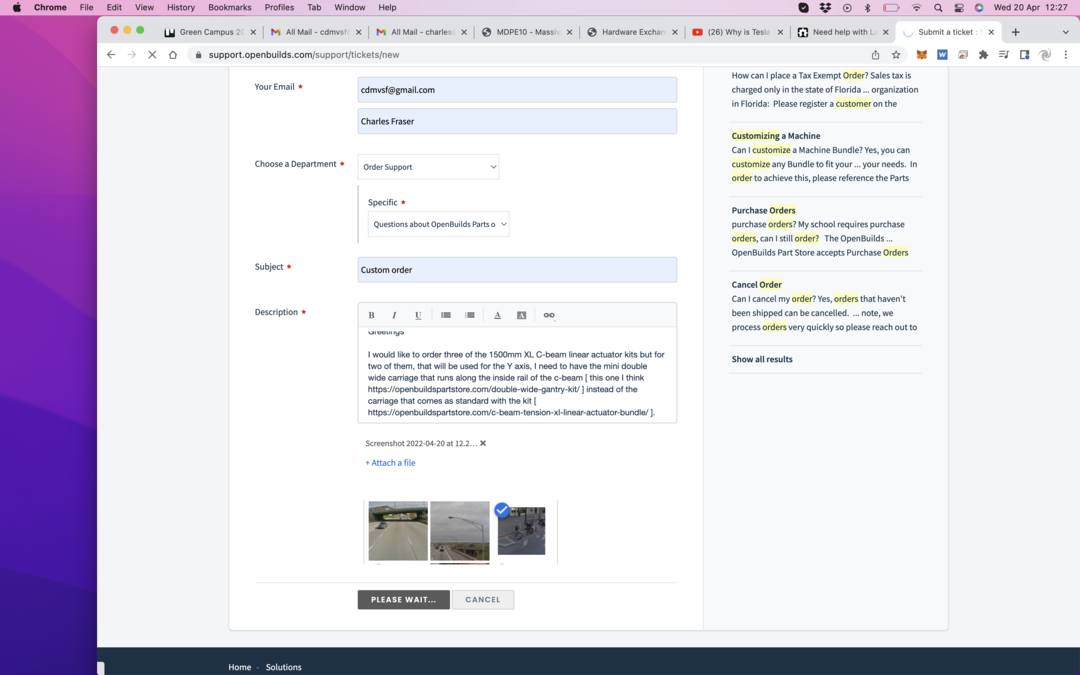

    Excuse me sir, I have tried about 20 times and that ticket form does not work. it always says capture error. Please can I have an email of someone in sales re:
    Greetings
    I would like to order three of the 1500mm XL C-beam linear actuator kits but for two of them, that will be used for the Y axis, I need to have the mini double wide carriage that runs along the inside rail of the c-beam [ this one I think Double Wide Gantry Kit ] instead of the carriage that comes as standard with the kit [ C-Beam Tension XL Linear Actuator Bundle ].
    Could I please have two 1500mm kits with the specified custom double wide gantry cart and one 1500mm kit with the standard cart?
    Please can I also have the extrusions and components necessary to join the Y axis plates to the X axis gantry as indicated in the below picture?
    Many thanks
    Charles
  26. Peter Van Der Walt
    13,749
    4,070
    Email: contact at Openbuildspartstore.com
    Catcha errors usually relate to script or adblock plugins in your browser
    GreenCampuLtd likes this.
