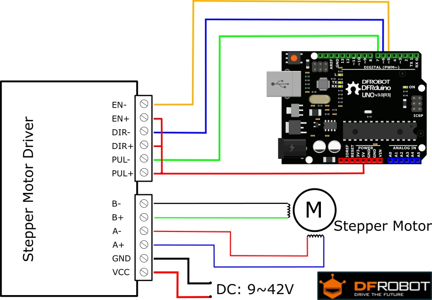

    So I am trying to make a stepper motor spin and am not having any luck. These are the components.
    Power Supply- https://www.amazon.com/gp/product/B078RYFMQB/ref=ppx_yo_dt_b_asin_title_o01_s01?ie=UTF8&psc=1
    Stepper driver-https://www.amazon.com/gp/product/B07S64MBTR/ref=ppx_yo_dt_b_asin_title_o01_s00?ie=UTF8&psc=1
    Control board-https://www.amazon.com/gp/product/B0093Y897A/ref=ppx_yo_dt_b_asin_title_o00_s00?ie=UTF8&psc=1
    Motor-https://www.amazon.com/gp/product/B00PNEQKC0/ref=ppx_yo_dt_b_asin_title_o00_s00?ie=UTF8&psc=1
    I have put pictures down below and a wiring diagram. Both lights on the stepper driver are on which are the power and alarm so im guessing something is wired wrong.
    Any help would be greatly appreciated.

  5. Giarc
    2,921
    1,620
    Here is a wiring diagram that works. I can't see yours because the links all appear broken. Are you certain you picked the right pairs of wires for the As and Bs? Both As have to be from the same coil and the same with the Bs.

  7. Rob Taylor
    Rob Taylor Master
    Dec 15, 2013
    1,470
    746
    Yep. I also like StepperOnline motors and I have that same breakout for testing the mill before getting Mesa boards. Those should be fine. The TB6600s are variable, it is possible to get a bad one or have it die. For the price you can't beat them for basic stuff though (unless you have three die in a row, somehow... Then you shoulda got a DM542 ;) ).
    Are you definitely seeing 36V out of the PSU? Do you have the USB port plugged into the computer with a male-male cable? That's required to give the board 5V power (which components need 5v power and which get power over parallel, I'm not 100% sure off-hand).
    I assume you just plugged directly into the X-axis plug and broke it out to go into the driver. If you're using terminals, you'll need to tell Mach 3 which ones you're using for which pins. The terminals correspond directly to the parallel pins, it's just a breakout board and not a controller of any kind.
    @Giarc's diagram above, while intended for use with grbl, is exactly how you should have it wired, into the corresponding socket on the BoB. If you need to tell Mach 3 the difference between active high and active low (what you have here, ie. "pull to ground for step") on the stepper driver, I don't know. If the stepper driver can even take active low, I also don't know off-hand. Some are step-on-high only. Though for a single axis, that might not matter so much in terms of variable frequency pulse trains, since there's nothing to sync. @Batcrave might be able to help some with the Mach 3 side of things.

  8. Jack Kelley
    Feb 23, 2020
    @Giarc and @Rob Taylor , thank you both so much firstly. I believe I have the correct wires for the A and B pairs, I did it looking at the diagram that came with the motor but I will check manually when i get back. I will also check for 36 V as those both seem to be the most simple problems. Here is a wiring diagram, hopefully it shows up. The 5V connection is via a USB cable attached to a power strip and the power light is on on the BOB.

  10. Peter Van Der Walt
    14,038
    4,122
    Disconnect the Enable wiring temporarily. If it starts working you need to invert the Enable signal in the config
  11. Jack Kelley
    Feb 23, 2020
    @Peter Van Der Walt
    That worked!! Just one question. Is it usual for motors to run rougher when the mach 3 motor tuning setting of "Steps per" is lower. It was automatically set up as 2000 so i changed it to 200 as 200 steps per revolution and it seemed to run rougher. I tried 400 steps per and it ran smoother than 200
