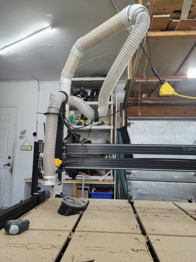

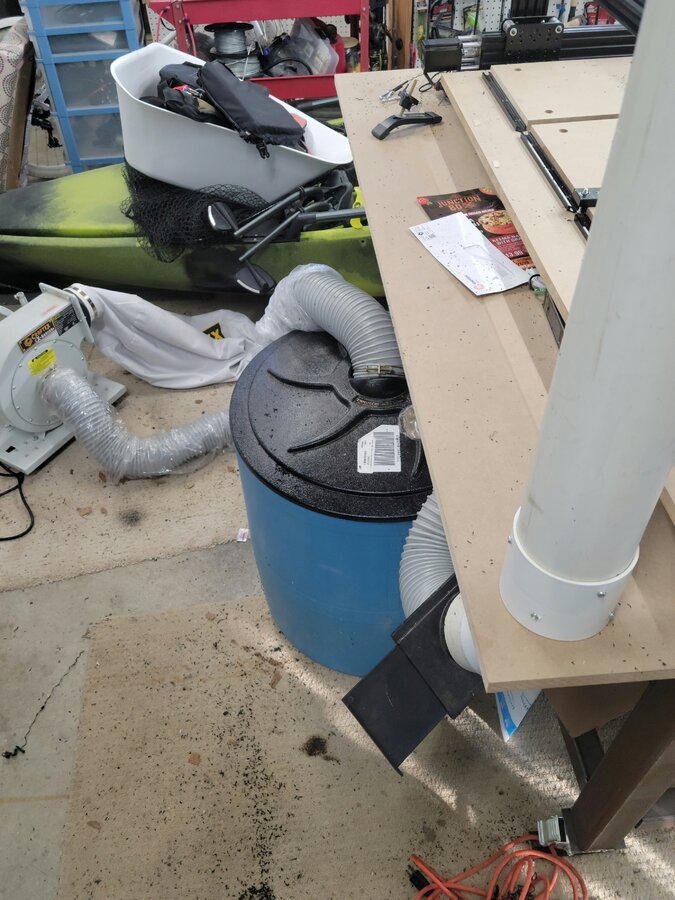

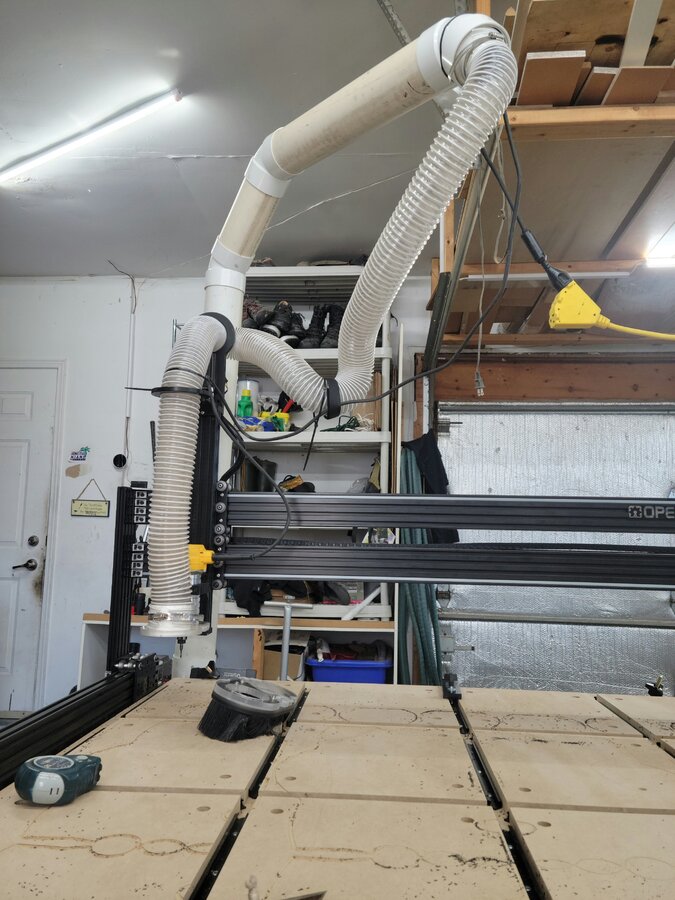

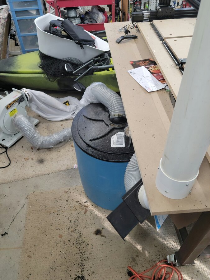

    I started using a shop vac, but found it way too noisy. I bought a 1hp dust collector and made a cyclone collection system. It's fairly compact and just takes up a bit of space behind my machine.
    The swing arm is made out of 4" tubing with 3" hose coming out the end to the dust shoe on the spindle.
    John Owen likes this.

  7. Tim Percy
    Tim Percy Well-Known
    Jul 26, 2021
    40
    35
    Here's some pictures of my setup.
  8. John Owen
    John Owen New
    May 12, 2021
    What dust shoe is that?
    That is my next line of research. I could build one, but I would prefer buying my first I think.

  11. Tim Percy
    Jul 26, 2021
    40
    35
    It is the Openbuild one, but I modified it for a 3" hose.
