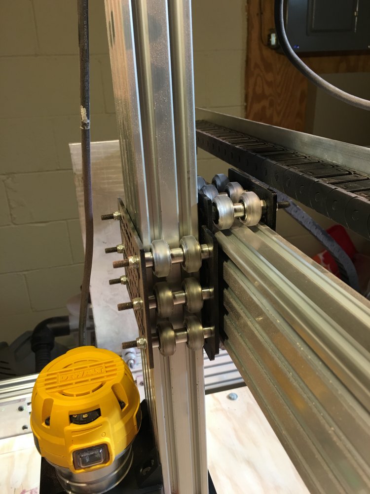

    I have also used a very similar design for my CNC. I am getting movement in on my Z axis in the Y axis direction. I am thinking about using your idea of adding wheels to the inside of the C-Beam. How has your machine been handling since you add those inner wheels? What is the thinness of the plates you used on your Z?
  20. Robert Bailey
    Robert Bailey Well-Known
    Mar 23, 2015
    117
    71
    we got rid of a lot of flex with the added wheels added on the back, with yours it looks like it is really high off the spoil board and using the openbuild 1/8" plates. I started out like yours then had the machine build
    its own replacement plates. every think on mine is 1/4" 6061-t6. my next rebuild will replace the wheels with bearing guides. I am finding that there is some wiggle in the wheels, some have more than others. if
    you are doing wood projects the amount of slop most likely will not be noticed. I posted a bunch of pictures , take a close look and if you need a better look at something I can post a different view of it to help you out.
    I also posted all the sketchup files also.
    Robert
  21. Ronald van Arkel
    May 7, 2014
    472
    245
    Hello Robert, the latest wheels with the "OpenBuilds" marked in them are better and should have no play with the bearings, the Xtreme wheels should have even less play. Still, we are looking forward to the design with only the bearings, it will be great to see :thumbsup:.
    -Ronald

    That is a really tall gantry, are you experiencing any flexing in it
  23. Rigga11
    Rigga11 New
    Apr 24, 2014
    15
    The Z rail is 500mm and I have a good 360mm of travel +- the size of the bit. I can not visibly see any flexing on the X (1000mm) rail and unfortunately I don't have a dial indicator to see if it is flexing. From what I can see the flex I am getting appears to being coming from where the two plates are connected between the X and Z. The plate are only 1/8in and I hope that by going up to solid 1/4in plates and adding the inside wheel like Robert has, that it will remove most of the flext I am experiencing. I plan to mainly do wood and acrylic projects. However it would be nice to have enough rigidity to be able to do some aluminum projects like making new parts to repair/build another cnc.
  24. Rick 2.0
    2,861
    1,528
    @Rigga11, If you're cutting your own plates, make them about 3" taller and move the upper set of Z-axis wheels up as far as you can. The short vertical spacing of the Z-axis wheels was an issue noted very early with the original Ox and that's why additional wheels were added higher up. The wider the spacing you can get between the upper and lower wheels, the more resistance you will have against leverage on the Z-axis rail and thus the less movement you will experience.
    GrayUK and Rigga11 like this.
