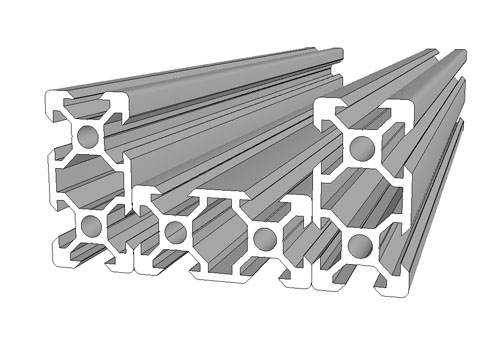

    While it is fairly easy to mock up C-beams using 20x40 members...
    I'm really not sure it's worth the effort in your case if you are trying to keep stress levels to a minimum. Getting a perfect match and having it perfectly square takes quite an effort and the 3 pieces of C-beam you need are such a minimal expense just buy what you need rather than fight with what you have.

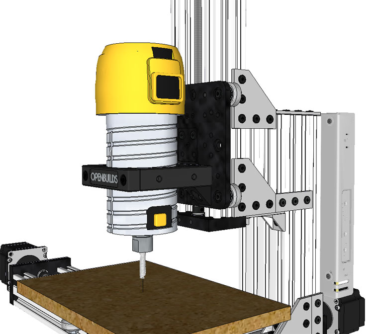

    Beyond that, you have a substantial amount of what you need already but you will need a few more parts. The most significant are 3x C-Beam XL Gantry Plate and 6x C-Beam End Mount - Ooznest | Kits, Parts & Supplies. The C-beams you will need would be 250mm for the Z-axis, 400mm for the Y-axis, and whatever suits your needs for the X-axis (350-400mm makes for a pretty usable axis). If you don't already have a proper spindle mount you'll probably want to pick one up. I'll leave it to you to figure out what you have to work with and what you'll need beyond that.
    As for the remainder of the build you should be able to transfer most of the screws, nuts, wheels, clips, (etc.) you already have and which are typically the most expensive part of the build. Below is a basic concept. The main column is just (3) 250mm pieces of 20x80 epoxied together with another (3) epoxied 110mm pieces of 20x80 used as the spacer to hold the Z-azis actuator assembly.
    With the epoxied layers you'll want to drill and run some long screws through the layers just to make sure if the epoxy ever pops the system won't pull apart and crash down on you.

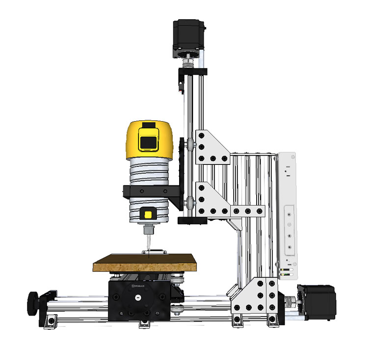

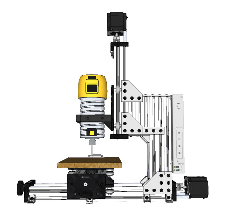

    Here is another concept mounting the Ox Z-axis plate to a regular MiniMill framework. It reduces the XL gantry plates to 2 and the end mounts to 4 but that's about as far down as you can take it. You're converting the X and Y axes to screws and you need the receiver plates to accommodate it.
    The framing uses a 250mm C-beam for the column and 110mm pieces of C-beam and 20x80 as the spacers.
    Sketchup file attached.
