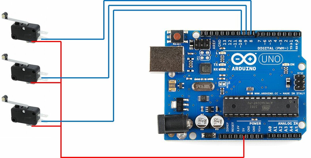

    The Net's glory is also it's curse, there are so many conflicting wiring diagrams, some old some new. Is there a 2020 consensus on the best way to install limit switches? i.e. normally open, normally closed, installing capacitors for buffers, looping positive, looping negative and on and on. System is Arduino UNO, grbl 1.1h, Candle 1.1.7.
    Any comments appreciated.
    A wiring diagram would be very helpful.

    This is kind of my point. That site shows the limit switches on UNO pins 9,10 and 12 which I am told (see my post under "pin conflict") changed years ago
    and now use pins 9,10 and 11. I also found a post saying all that was required for suppression was a 47uF capacitor across each pin to ground. But that was for V.08 not 1.1, still valid?? Have also found diagrams that loop 5v thru the switch to the UNO and others that loop ground. Very confusing!! Was hoping to find something
    up to date and in agreement.

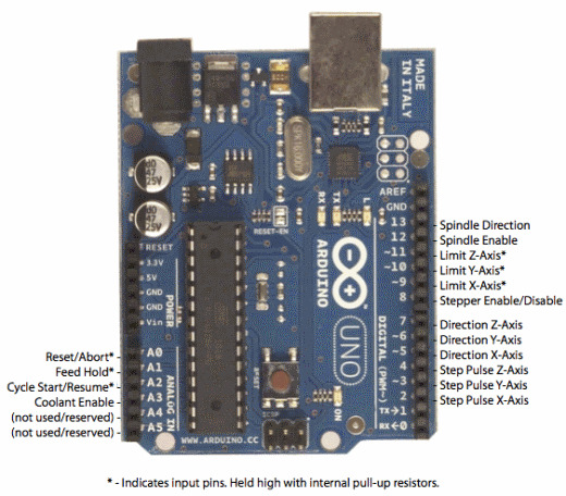

    These are the images I have of limit switch pin assignment. limit switch to arduino.jpg UNO pin layout.jpg
    Was told, by Peter, that the old pin assignment applied to V0.8??
    Still not sure if the UNO is looking for a closure to ground or 5v.

    This was the poster on my EE sites logic. Again refers to 9, 10 and11. Were just trying to get this right not cause conflicts. ROUTER BASE 200024.jpg

    So I finally found the grbl/wiki for 1.1 that everyone was referring to and had my questions answered.
    Many thanks for your patience. Any thoughts on my last post about the capacitor logic?? ignoring
    the wrong pin locations??

    Where did you find those pictures? Definitely not at the official GRBL Wiki. That pin assignment is from GRBL 0.8 if I recall correctly. This is from the link above I mentioned. You can see the correct pin out. [​IMG]
