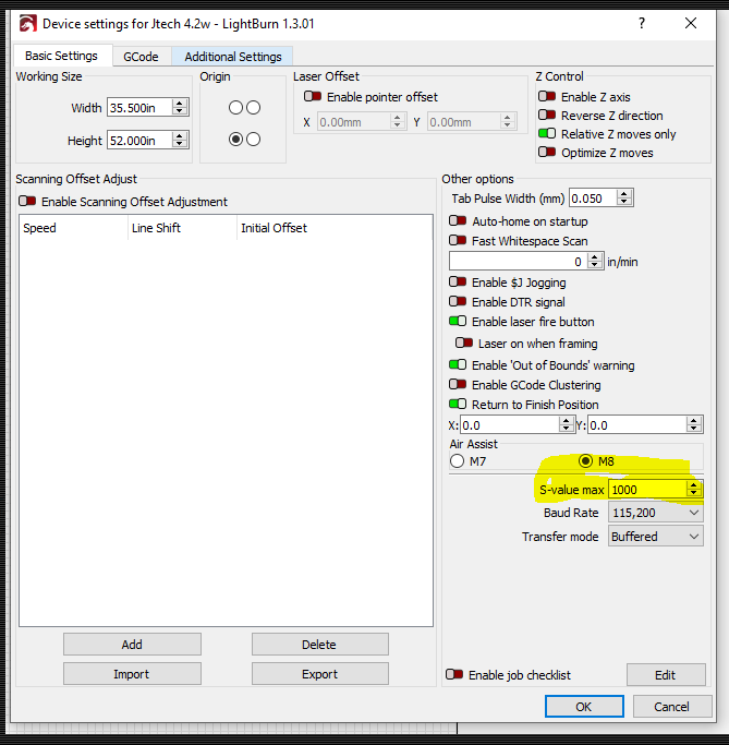

    Here are some screen shots I sent to Lightburn Forum.
    going to be away from shop for a while but will check back in later.

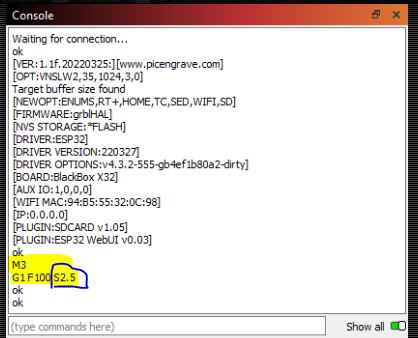

    Console with Fire Button does the same G1 trick we do, so it is interesting. 2.5 of 255 = 1% though, it might be too low to initiate the laser diode (some has a little blank spot near the bottom range)

    OK hashing things out with the Lightburn Forum and we came up with my old controller $30 was 255 and Blackbox should be 1000 so I changed the values and the Fire button does work but even at 20% power in Lightburn software it's difficult to see. My overhead shop light was off when I discovered the fire button was working. All is good I guess.

    Doesn't really matter, but whatever you have $30 set to, should match what you tell Lightburn you used as Max too (So it all lines up)

    Screenshot "Console with Fire Button" showed Lightburn sending S2.5
    When you say you are sending 20%, if S-Max is 1000 then 20% should send that line with an S200 - does it according to the log?

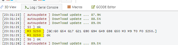

    Ok, Control Software [m3 s250]
    Lightburn Software [m3 G1 F100 S200]

    Then Lightburn is sending the right command, S200 is 20% of Max=S1000
    If 25% is massively brighter -the laser module itself may not be as linear as some of the better ones
