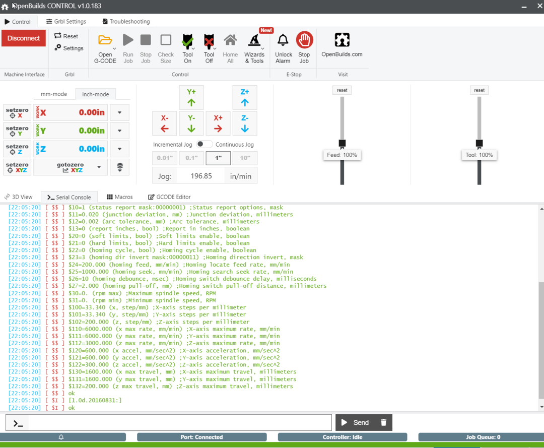

    Where to even begin.
    I ditched CAM because it freezes up creating tool paths. Switch to carbide create and zero issues.
    Now, im trying to drill holes in my wasteboard for threaded inserts and the control software becomes un responsive, but has a major delay before it completley doesnt reapond. Works fine for a little bit before all this happens.
    I cant get the control software to save my zeros, so when the above happens in the middle of a cut, im SOL
    Are my limit switches in the right spot? They are at bottom left. I was told that was incorrect, but double checked the video and thats where it says to put them.
    Im about ready to burn this thing and go buy an inventables or shapeoko if we are being honest. Really regreting my decision to buy the lead right now.

    Hi Gregers, it's a bummer you are having so much trouble, maybe I can help with a couple (3) items.
    1) reliability is something you need to work out or you will never get anything done, you should be able to do hours long projects with no issues.
    There are many reasons why you might be having "lockups", some of these include; laptop usb settings which power off usb after some time (there are windows settings which disable this), Overheating drives (turn the current down some or add more cooling fans) poor quality USB cables, RF noise ("star" grounding might help as will shielded power and signal wires, Move spindle power away from usb or limit wires).
    Your pc might just not a be a good mach for the software. There are tons of control software options, my go to for troubleshooting hardware or software issues is universal G-code sender "platform", it's been around a long time and has been reliable for many people. Also if using windows 10 do control-alt-delete - task manager/startup/ and disable all the crap that accumulates in system tray, this will free up resources.
    2) your "Limit switches" (i think you mean "home switches") can be anywhere you want, setting $23 determines which way the machine seeks home.
    3) no software will remember your work offset after a hardware or pc crash, but if you reference off the home position each time (jot down your offset from home to your starting point (work offset) then after a crash home again and plug in the x,y cords you saved before.

    1) homing and offsets is an advanced function. Until you have some hours under the belt:
    1.1) Grbl settings, Hard Limits, Soft Limits, and Homing , Disable
    1.2) remove your limit switches. Doing so will help your brain to not have to worry about Machine Coordinates. Just worry about Work Coordinates
    1.3) every job, jog to where 0 should be and SETZERO. Every time (even with limits. Zero tells the firmware where the stock is, which is never the same place, so the idea of Saving Zero is a blocking mindset here)
    2) if our Software stops you from working, then dont use it. Grbl has hundreds of applications, why not try some other ones that work better on your PC. Like Universal Gcode Sender, CNCJS, and many more :) - instead of giving up, just try something else, we are all different so therefore we all like a workflow that fits our unique needs. The beauty of an open system is you have plenty of choice :)

    Video may be bottom left, but actually Grbl Wiki explains it all nicely, and prefer top right. But actual limit switches as a safety actually had 6, 2 per axis on both ends. So largely irrelevant. Did you read my post with the picture though explaining why setting zero 0.1mm from the switch is a bad idea?
    F12 works for sure, sure you had focused on the window? That PC might need a reformat if simple built in keybindings doesnt even work right man

    What about after rehoming: zero, work coordinates, g30 etc are all stored relative to machine position which can only be found/set using homing. After homing, all the rest should be where they was last set. Crashes etc wont overwrite it either as it was set at the start of a job
    Re software: spec of PC? And refer list mentioned in other thread, gonna need the gcode files and screenshots to help you any further on that one :)

    Homing = G53 Coordinate system = machine position = set by homing switches only
    Zero in G54 (default work coordinate system, but know that G54-G59, G28, G30 are all different layers to this) = Work Coordinates = set using G10 (set zero button)

    Gregers, The button looks like a home (top middle).. Yes $23 lets you invert or reverse any axis you want so if you hit home and it goes the wrong way on X change that direction at $23 in the grbl settings

    Can you check out this gcode to see if you see anything out of the ordinary? I suspect not, as the simulation looks as it should.
    The issue I am having is that the letters are not spacing right and get higher and start overlapping each other with each letter. It ran up into my other v carve program I had on this sign. Not sure what the issue is? Anybody have any ideas? I attached the gcode and ill attach a pic of what it is doing. The big letters should be running parallel with the text above it. The first letter "T" is in the correct spot, but goes downhill quickly from there.

    Pic attached. The second 'T' starts to cut into the text above, then the 'O' is full on into the middle of the text and also overlaps the 'T' that was carved before it. I assume the 'R' which would be the next letter would be even worse.

    Skipping steps. What controller do you have?
    Same reason you loose your zeros: It skip steps because the current is not set properly (too high = overheat and loose steps, too low = not enough current and stalls and skips)

    Its the black box.
    First time ive had this issue. When i was flattening, drilling and doing the grid on my waste board it never had an over heating issue? Went through the other program that did rest of the text you see without issue? Why would it happen on the second letter in of this program, only 2 mins in?
