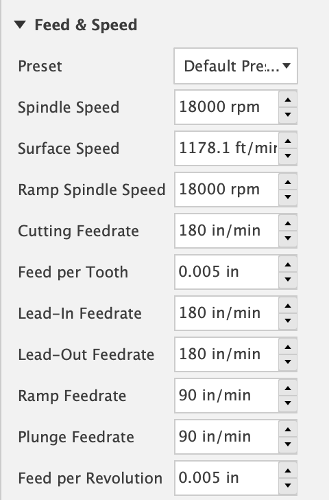

    My bit specs were imported directly into Fusion 360 with the manufacturer recommendations. This is what the feeds and speeds were set to based on that.
    Okay, I can give that a shot. At the top and bottom of my parts it's cutting straight across the grain and I was thinking it might have been struggling there and possibly skipped. Since it looks like it only skipped in the x-axis. I was reading some other posts where you mentioned the current to the motors might need increased slightly. Is that something you think could benefit me here? If so, would I slightly increase the current to all of the motors equally or just the x motor?

    First just try a more conservative cut with a regular bit as a test - lower DOC or feedrate
    Are they assuming a $2000 machine or a $100000 machine?

    My point is, manufacturer ratings might be on the aggresive side on a hobbyist router. Their main business might be machines a lot larger/stronger than yours. Derate accordingly
    Logan Blankenship likes this.
  10. A.J.W.E. Klappe
    A.J.W.E. Klappe Well-Known
    Aug 13, 2017
    126
    86
    I see a service speed of 1178.1 ft a min is that oke?

    Thanks Peter, after going through this and a bunch of other charts and documents online, I think my main problem is thinking the manufacturers recommendations were fine with my machine. This is the first time I've had issues but also the first time I've cut a hardwood this hard. Do you know what would be a good average range feed range would be for cutting hardwood on the lead 1515? I saw another post on here about the lead 1010 where someone was running around 120 IPM which is decently slower than the 180 I was running. I also saw a few videos with some other hobby machines where people ran as slow as 60 IPM. So I'm a little unsure now of how much yo cut back on my machine. Do I cut it in half and start at 90 then work my way up until I hear the machine start to struggle? Or is there a range that's expected with this particular machine when it was originally designed?

    You were cutting at 4572mm/min (180 ipm) That is very fast. For most woods, I started with 100ipm (2540mm/min). Why that number? It was the default number in Sketchucam when I did my very first cut. ;)
