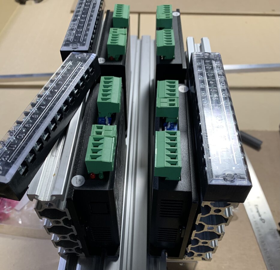

    Stepper drivers, power supplies, terminal strips, wire, and wire ends all showed up today. I’m playing with an idea to mount the power supplies and steppers. Tell me why this won’t be a good idea.
    Use a 2080 and a 2040 for a base, connected together, with 2 2080 verticals that the steppers will attach to. The terminal blocks on top of those. One power supply attached to each side. The arduino on a plexiglass top. And put a fan on one side blowing air through the center. The aluminum extrusions will act as a heat sink.. I’m trying to think what’s wrong with this and not finding anything. The aluminum will all be 250mm so there will be a slight gap between the stepper drivers.
    thoughts on this?

    Not a fan to be honest.. I cannot quite put my finger on it.. but something is off.. I feel that it would be a nightmare in the event someone fails and you need to trouble shoot.. also, that is a lot of heat that needs to be dissipated.. I would mount the drivers next to each other with enough of a space between to allow for decent airflow. The 2080 and 2040 will also soak up some of the heat, which while nice, but based on that configuration, would soak up a crap ton of heat.. and I don't think there is enough air flow for a fan to dissipate it. Those extrusions do not have enough surface area. Think fins on most heat sinks, there is a reason they are not all flat pieces of metal.

    I’m trying to keep it Openbuilds parts as much as possible, but I’ll play a bit more. That was first idea. As for heat, these steppers don’t even come with heat sinks so I was thinking that even the amount added by the extrusions is a step up from what they have. But agree that it would soak up a lot of heat. Maybe I’ll just say screw it and go get an enclosure to mount everything into. McMaster is only a short drive from my house.

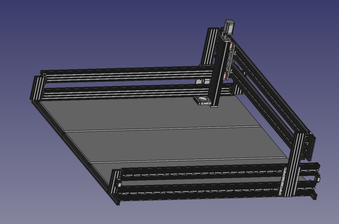

    Machinist Santa showed up tonight at my house. The first of the new end plates arrived, to replace and combine the 2 c-beams and house the bearings for the ball screw arrived. These are the first set, with more to follow.
    He even redesigned the plates for the x-axis to eliminate the angle connectors from the mix and use the bracket to mount to the uprights. Now I need to get the aluminum for him to make these new improved mounts.
    I guess I’ve been a good boy this year
    Machine is still running, so I guess these will have to wait. But, the bearings went from a 26x10 to a 28x10. I will try to get the CAD file for these, and the motor mount sides as well. For the X axis, the 2 narrow spaced holes will move out to the outer location, and then he will add 2 screw holes through the entire plate to attach to the side of the uprights using drop in T-Nuts and 50mm screws, so the X will have a 220MM plate holding it to the uprights on each side. That will take care of the Y and X axis. Lastly, I will need to do the Z plates, after I figure out how I want them to be.. Still using the 8mm ACME screw for the Z since I need to make a custom nut block for the ball screw.

    For the X/Y plates, I am using 3/8". For the end plates on the Y/X, I have started the change over to 1/2" for the Y and 1" (Milled to 20mm) for the X. The X will have the attachments and end caps milled into one. Attached is the rendering for the motor mount side of the X axis. This will replace the angle connectors for the X/Y uprights into the end plates.
