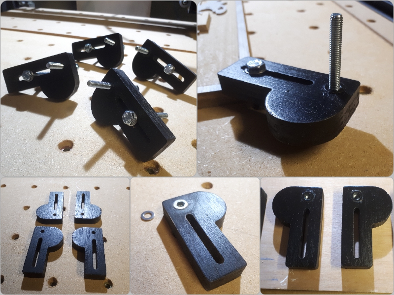

  14. Colin Mccourt
    Colin Mccourt Journeyman
    Jan 23, 2019
    354
    184
    I made a set of P clamps that screw down into the D Nuts in my MDF Spoiler-board.
    & I also use double sided tape on occasion.
    MaryD and gregers05 like this.
  15. gregers05
    gregers05 Well-Known
    Feb 15, 2019
    131
    33
    nice, I am planning to make a few of these.
    Colin Mccourt likes this.
  16. Colin Mccourt
    Jan 23, 2019
    354
    184
    If So.
    Grab the zip file HERE
    PS Obviously the upright bolts don't have to be that long, (as in my photo). They were all I had to hand.
    Regards
    C
    #16 Colin Mccourt, Apr 3, 2019
    gregers05 likes this.
