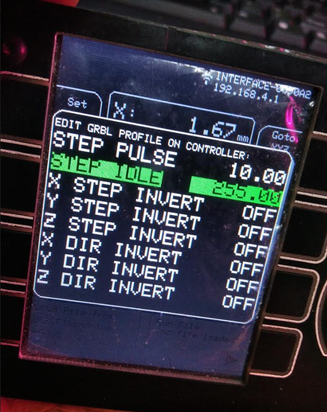

    Thanks, I just read about the command, but is there a way to change that using the interface control box?
    13,751
    4,070
    Tools and Util button on the left side of the Jog screen > Edit Grbl profile > STEP IDLE and set to 255, yes :)
