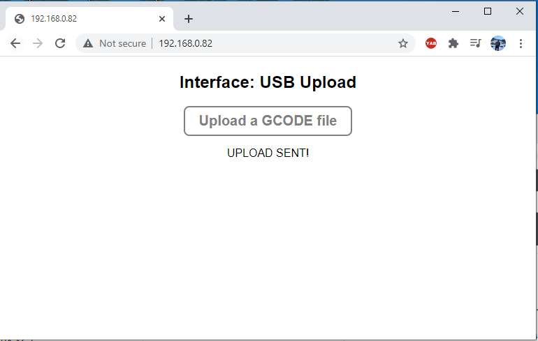

    Thank. Have you or anyone tried 'over the internet' file transfer to INTERFACE so far? @Peter Van Der Walt Is it something we can do? If so, please suggest.
    14,000
    4,112
    Not the internet, but over the local LAN yes
    1) Follow docs:interface:wifi-setup [OpenBuilds Documentation] to get Interface on to your network
    2) On the LCD it shows the IP address
    3) Type that into a web browser and use the big "Upload a GCODE file" button to select the file you want to send. Depending on the file size, walking over and fetching the USB drive may be faster
    fathmi and sharmstr like this.

    @Peter Van Der Walt This is all I've got while trying to connect to INTERFACE remotely within the same WIFI network. What I am doing wrong? The interface is powered on and running...

    Do you have the latest Interface firmware installed?
  7. fathmi
    fathmi New
    Feb 20, 2016
    19
    I have 1.24 installed, but not the latest.
  8. sharmstr
    2,035
    1,431
    1.24 is the factory version which doesnt include wifi upload of gcode files. Update.
    You MUST update via Control for this update. Dont use the supplied USB cable. You need a data cable. Do make sure you are on the latest version of Control. Read the steps carefully especially the ones outlined in 3.3.1.4 docs:interface:firmware-update-control [OpenBuilds Documentation]
