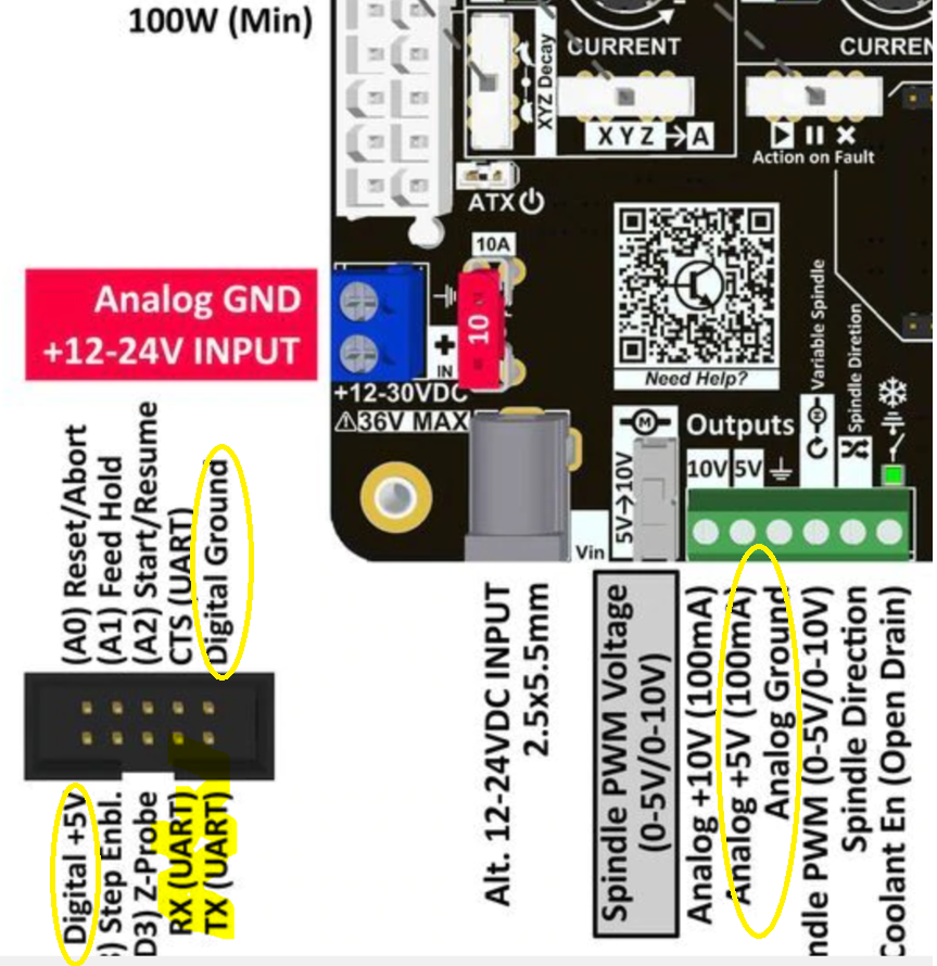

  20. pilotjunky
    Sep 22, 2015
    Has anyone got the INTERFACE device to work with XPro v4 board?
    Got it working on my Blackbox v2.5 with the mod as instructed. I’ve update the firmware... all good. What’s the trick to getting the Interface device working with XPro v4? Anyone had success... it just seems to keep rebooting when connected to v5, GND, Tx and Rx in the XPro v4. Thanks Rich.
  21. Peter Van Der Walt
    13,970
    4,100
    5V regulator on xPro may be insufficient, try powering Interface off USB-C as well (spare old phone charger, and included USB-C Power cable)

  23. pilotjunky
    Sep 22, 2015
    I think the power supply issue is resolved per the suggestions... but I cannot seem to consistently get the RX/TX to work... I have had it working but now it won't connect to GRBL... Using the two pins highlighted below on the board. I have tried all the simple "restart" debugging no luck. It's 100% consistently working with OpenBuilds Control.... appreciate any debug suggestions (aside from buy a BlackBox :) )
  24. Peter Van Der Walt
    13,970
    4,100
    Only those two? You need three: GND to reference the RX TX voltages against :)
  25. pilotjunky
    Sep 22, 2015
    No, I've also put the 5v through it... something is missing here and I can't figure it out... can't get GRBL communication... must be a trick to getting that header to work which then allows serial data to flow.
  26. Peter Van Der Walt
    13,970
    4,100
    Maybe the switch on the right near the USB port?
  27. pilotjunky
    Sep 22, 2015
    xPro v4 with INTERFACE - I got this working and thought I'd report back to the community on how. Mike from Spark Concepts helped me out.
    1.) Jumper CTS (UART) to the Digital Ground pin next to it. (Mike wrote: For the external RX and TX signal, you will need to pull the CS pin low on that header - the easiest way to do that is to jumper pins 8 and 10 on the shrouded header..These are the two rear pins, closest to the GRBL logo on the board)
    2.) Digital +5v pin to the INTERFACE 5v pin
    3.) Rx (UART) pin to the Tx pin on the INTERFACE (Remember it's Rx to Tx because the natural instinct for the layman is Rx to Rx which is incorrect!)
    4.) Tx (UART) pin to the Rx pin on the INTERFACE (Remember it's Tx to Rx, because the natural instinct for the layman is Tx to Tx which is incorrect!)
    5.) Connect Ground a pin from xPro to INTERFACE Ground.
    5.) Flip the Little switch beside the USB port to get 5V to the board without USB.
    6.) Use supplied USB-C Power cable to external 5V source such as Laptop USB, or Battery, or Plug to power the INTERFACE because there isn't enough from the xPro v4 alone.
