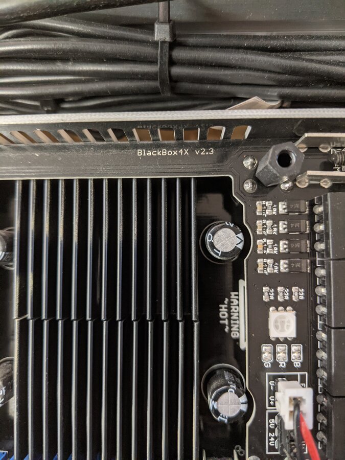

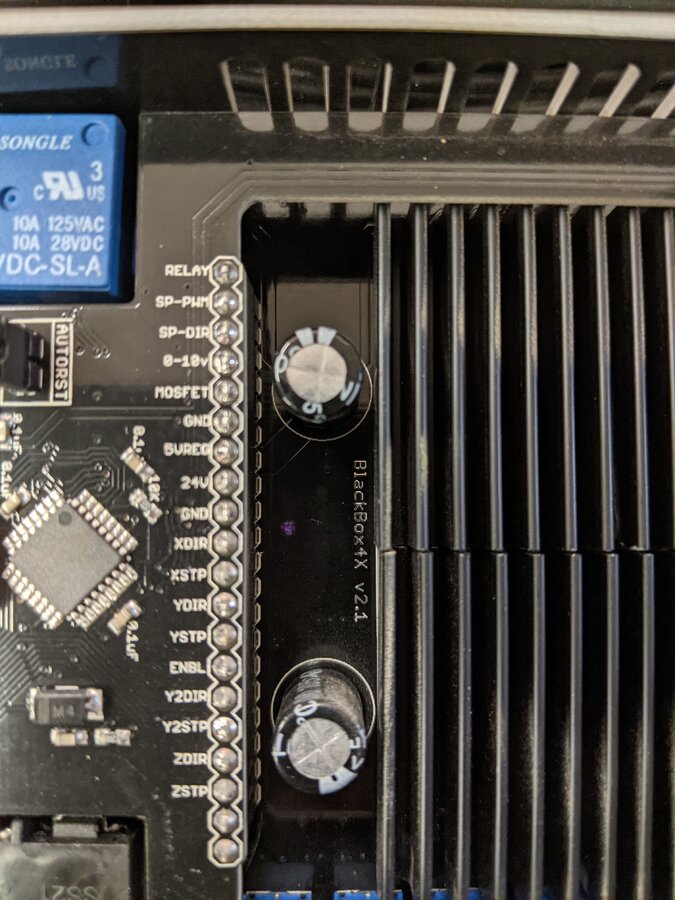

    The Interface docs have instructions for BlackBox 2.4-2.6 and v2.7. What should I do if mine is at 2.3 on the brains board and 2.1 on the base board? Is it incompatible? Am I SOL? Or, do I just pop out the FDN340P transistor and carry on as though it is a 2.4 board?

    Same as V2.4 :)
    Cool! There are very few of those out there! :) Good memories man!

    Got it - deface a collectible. ;-)
    Thanks for the quick response!

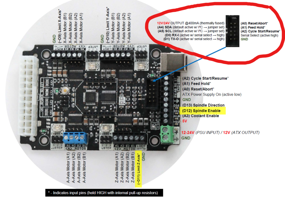

    Look at this https://raw.githubusercontent.com/Spark-Concepts/xPRO/master/wiki/xPRO pinout.jpg. The Tx and Rx pins are available. Just find a convenient 5 volt ad ground. Ground across from Tx.
    Then read this docs:interface:connect-generic [OpenBuilds Documentation]
