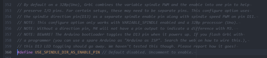

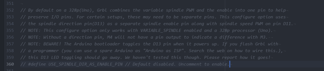

  20. Peter Van Der Walt
    14,023
    4,117
    M3/M5 Position is for Plasma. Putting a PWM signal into the relay will make it chatter. Varying S values like used with a spindle uses PWM. Use the Enable function as indicited above and in the documentation.
    And
    And
    No need to experiment (as mentioned above and in the documentation, there are just two standardised control schemes - 0-10v only, or 0-10v+run signal via the relay. Just follow the documentation. Move jumper, recompile Grbl. It's all in the Documentation

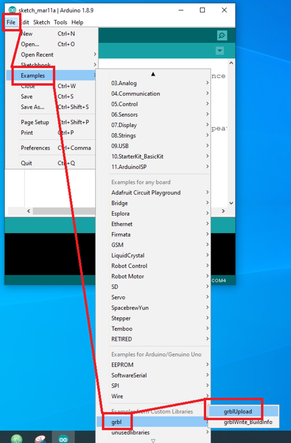

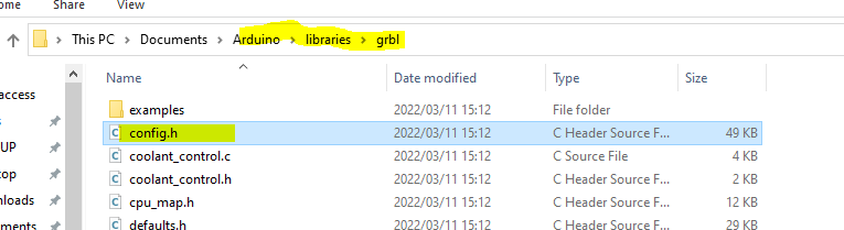

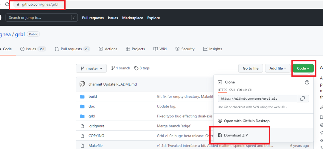

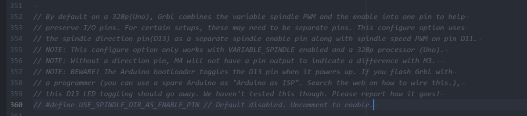

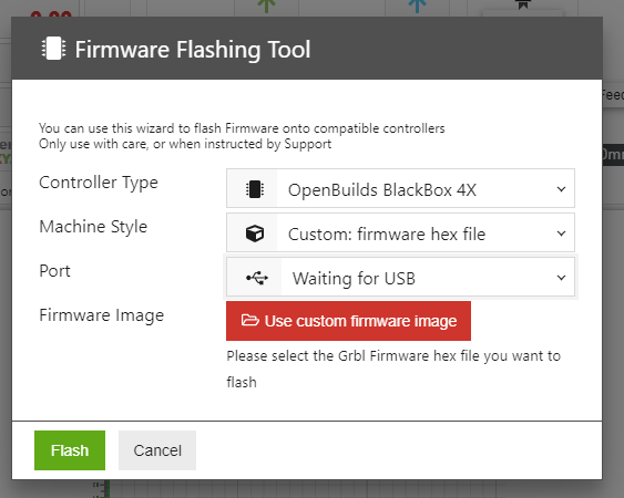

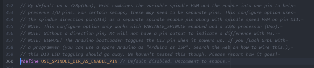

  21. Peter Van Der Walt
    14,023
    4,117

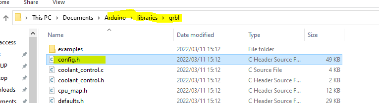

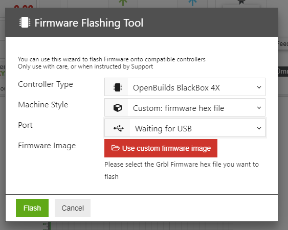

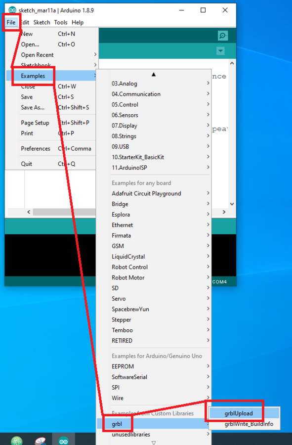

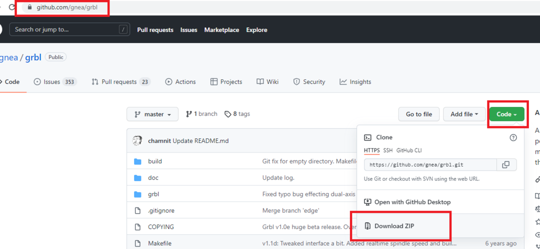

    I am trying to offer you support on a product we don't even supply. Have you contacted the VFD vendor and asked for support yet? Explaining that "I want to use your VFD in an application that only has a 0-10v output accesible by default. Can you help me with VFD parameters to enable spindle start and speed control using only a 0-10v signal, and how to enable Minimum Frequency properly so the spindle shuts dows if the 0-10v signal drops below 7200rpm? Here's how they use a HY series inverter VFD Spindle Control via OpenBuilds BlackBox Controller and Software can you advise me on the equivalent parameters for the GT series I purchased from you?"
    (for example)
    Otherwise use the section from our Relay documentation (you will have to recompile Grbl but that is incredibly easy. Edit that one line in config.h instructions are in the file. Open the Grblupload from Arduino examples and click Upload.

    Right, so here's what I did for you
    1) Downloaded the Grbl source code as a ZIP file
    2) Extracted the "grbl" subfolder into the Arduino > Libraries folder on my computer
    3) Inside this folder, I edited config.h. I scrolled through it and found the section talking about USE_SPINDLE_DIR_AS_ENABLE_PIN which is also mentioned in our documentation
    4) I simply uncommented the line by deleting the doubleslashes and saved the changes.
    5) I started Arduino and loaded the grblUpload example as per the Grbl Wiki documentation's compile page instructions:
    6) If I had your controller hooked up I'd now just have one button left to click: the Upload button in Arduino's top toolbar
    The use of the word 'Compilation' sounds complicated, but this is all it takes :)

    For you however, I've compiled it to a HEX file (attached to this post by doing the above, it's zipped, remember to unzip) and all you need to do is:
    1) Open OpenBuildsCONTROL
    2) Go to Wizards and Tools > Firmware flashing tool
    3) Select BlackBox, Machine Style: Custom, the corrrect port, and browse to the HEX file provided here using the red button.
    4) Click FLASH - Check the log and make sure it was successful.
    Don't forget to move the jumper to the DIR/VFD position: docs:blackbox:jumper-relay [OpenBuilds Documentation]
    Wire COM to one relay terminal and S1 to the other: See (f) of section 2 of docs:blackbox:layout [OpenBuilds Documentation]
