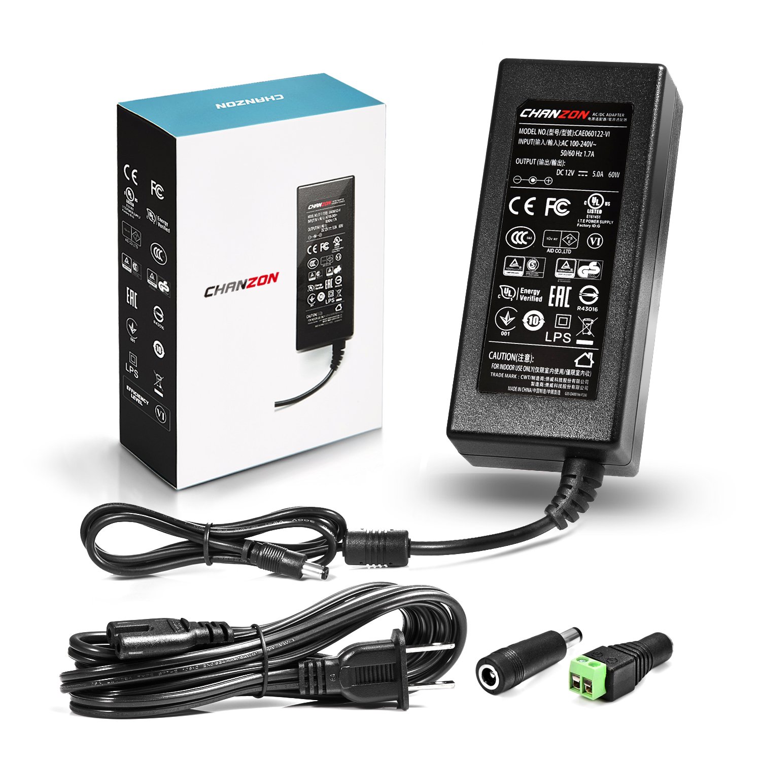

    Another issue I have is the power supply. I got the 12V Mean Well power supply from OpenBuilds, but it seems you have to connect wires from 120VAC to the terminals via screws, and all of that is exposed, which is hazardous for my application. Are there power supplies that only have the lower voltage (12V) exposed?
  15. Rick 2.0
    2,862
    1,528
    Consider adding a PowerCase Kit to the power supply. I'm not sure if they have different versions for the 12V and 24V power supplies but you might specify which model it is for when you order. If you have a 3D printer there are also a number of cover designs on Thingiverse.
  16. Rob Taylor
    Rob Taylor Master
    Dec 15, 2013
    1,470
    746
    Basically all PSUs come like that. Normally it's shielded and secured in operation, inside an electronics cabinet or similar.
    The PowerCase kit is a good idea if the PSU has to be out in the open for some reason, whether the OB one or a DIY version. Otherwise... Maybe use an ATX power supply instead?

    Anyway, would something like this work: It's 12V, 60W, and I only need to power 1 NEMA 17
  18. Peter Van Der Walt
