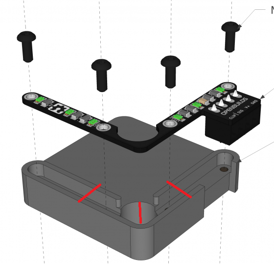

    I have made my own X, Y, and Z touch probe. I tested the probe to see if I it would work. I can zero all
    3 axis independently. I have not use it to do all 3 at once since I made mine on a manual mill at a Makerspace and it was I used this project as my way to learn how to mill Aluminum. The sides are not even, one is 0.409 inches and the other side is 0.467 inches and it is 0.59 inches thick. I know that the piece is square and level (since someone else made it for me). The sides should be correct since I only milled in a square pattern. There is a hole that I drilled through the zero point so that I can see the corner of the wood.
    If I can't use the probe, I take it that I will need to make a Macro to do the procedures that the probe does.
    Thanks in advance.

    Select Probe type: Custom in the wizard (bottom of the window) > click the gear > enter your offsets

    Thank you for the information so quickly. I did what you told me to do. However, when I did that (Also made sure of the bit was corrected diameter). I got the following results which I could fudge, but there may be a reason for it. When I remove the probe and moved the bit to the exact corner, I got the following readings, x = -6 mm, y= -6 mm, and z = 6 mm. Is this an offset or do I need to make an adjustment to the numbers that I placed for a custom probe? Thanks again, I want to get this correct and not make changes when I should not make changes.
    Maybe my micrometer is off by 6 mm?
    Harvey

    You'd need the https://docs.openbuilds.com/xyzprobe/
    Offset = distance between edge of probe, and edge of material - as probes have an overhang edge you hang over the stock
