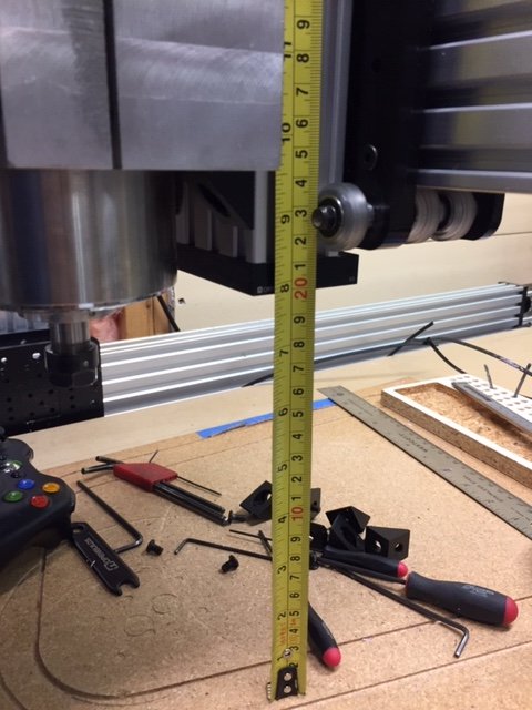

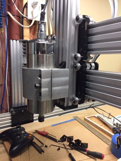

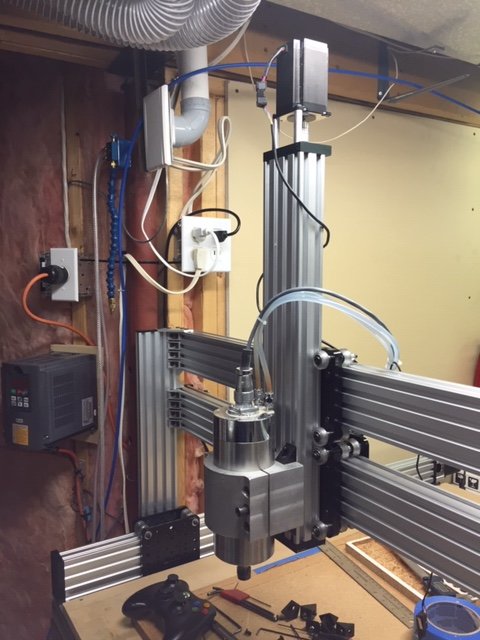

    How heavy is that water cooled spindle? It looks like it's 80mm diameter, so 2.2kW? Is that the ER20 collet or ER11? So many questions I know! I want to know if I can put a 2.2kW (5.3kg) spindle on the Lead1515 with the high Z mod without it flexing.

    I have the 1.5kW with ER11 collets. I did not weigh it but this information should be available from the vendor.

    2.2kw is way overkill for an extrusion based machine, not only weight but also on the ability of the frame to resist the cutting forces, you'll never be able to utilise the 2.2kw because the frame would deflect before you are putting that much power through the cut. 800w is a nice sane size, lighter too.
