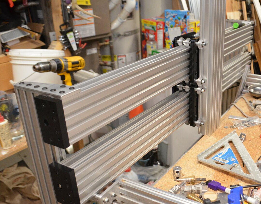

  24. Rob Taylor
    Rob Taylor Master
    Dec 15, 2013
    1,470
    746
    Looking at the difference between the two setups on the Part Store... One's moving rail, one's moving carriage? High-Z doesn't look like it could feasibly use moving rail, it would lose too much range of motion for any reasonable length of rail.
  25. Mark E. Crum
    Apr 13, 2019
    Thanks Rob, I have spent the better part of the night relearning Sketchup and reconfiguring the Lead Machine 1000x1000 to a Z-Mod 1000x15000. It actually looks like it gives a very healthy clearance for material thickness. Depending on the length of bit used you can get at least 6.5 to 7 inch clearance. I'm going with it and I'll report back on the outcome. It really is not that much difference. It may cost a bit more but not much really. Note, the longer the bit, the less clearance... But I really only needed a few inches. We will see.

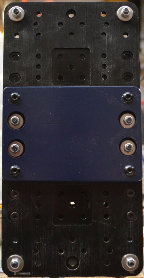

    Just turn it around like I did on my lathe. But I milled a plate that holds the two sections together. The Cbeam is what keeps the two High Z mod plates tied together which is why I made my own plate to serve this function.

  28. Mark Carew
    2,745
    2,410
    hello @Spikar Looks like its 36" in the highest position
  29. Jdubster3d
    May 22, 2019
    61
    13
    Thats a nice way to do it, you dont happen to have a machine file for this plate if it worked well do you? I am about to do the same thing thanks
