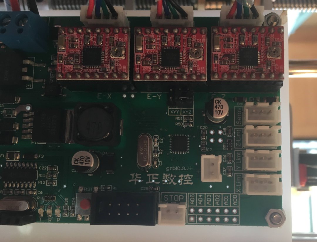

    New to the forum and I've just completed assembly and modification of a Chinese CNC Router.
    I have limit switches mounted now on 2 on X, 2 on Y and 1 on the top of Z, but I can't figure out how to wire them to my Chinese 0.9j GRBL board.
    I have looked at many diagrams for wiring in series, but my GRBL Board has 3 pins on each of the X,Y and Z limit inputs. These are marked + - and S on the backside of board.
    Can anyone suggest how I should wire a Normally Closed circuit to this with my 5 Micro Switches, please.....?
    Image of mystery board attached with Limit Pins to the right of image.
    Many thanks in advance,

    I don't know that board either but the 3rd input pin (S) must be the signal pin and would be used together with the +/- pins for an optical sensor connection. If you are using micro-switches however, then just use the S and ground (-) pin, the "S" to "normally closed" on the switch and ground to "C" on the switch.
    Just do not wire it wrong ( keep away from the + pin - that's for the optical sensor)

    Thanks for your advice. I've connected 1 micro-switch as you suggested and it's now working. To get left and right limits on X Axis, should I connect Micro-Switches together via COM pins, and to -, and wire both NC pins together into S on the board?

    For Normally Closed switches you need to wire two switches on the same axis in series - signal (control board) to nc (switch one), common (switch one) to nc (switch two), common (switch two) to ground (control board)

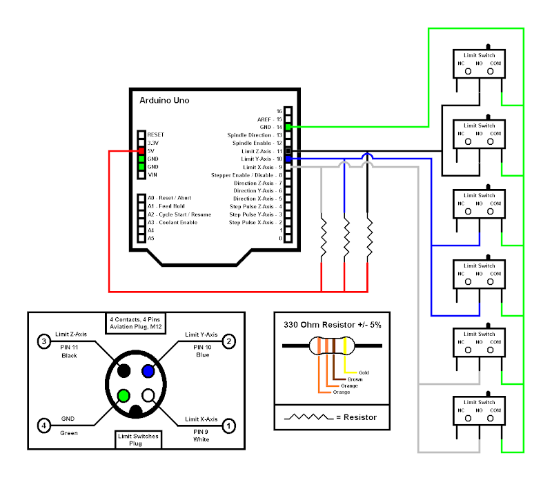

    Alex Chambers likes this.

    Bear in mind however that is for normally open limit switches.

    Yes Alex, and I believe pin 12 should be used and not pin 11.

    Can't help with that one @Christian James, but hopefully someone who is familiar with that set-up will clarify that before someone tries to use that diagram. I think @sharmstr has used an arduino and may be able to help.

    Refer to the Grbl wiki for all the pin information gnea/grbl

    213
    Yes Peter, that confirms what I thought and how mine is wired. Pin 11 has been grabbed for use by the spindle while the Z switch pin has been shoved onto pin 12
