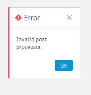

    Hi Peter,
    I cant seem to get this to work. it says it is an invalid post processor when I try to open and use, (see below).
    Any Ideas?

    Have you had a Fusion update since you installed it?
    This info might fix it, it refers to using my post processor for the Duet controller, but the same issue might be affecting the Openbuilds one ;
    Fusion 360/Duet post processor

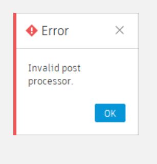

    Thank you for this Alex, after checking the box was already correctly ticked as indicated. But it was worth a check just incase.
    I have done the good old trick of a reboot of software (fusion). This seems to of partly worked in that I no longer get the error shown above and I can access the Post Processor. However, the file now fails to export (see below).
    I also noticed on the Post Processor selection it does not have compatibility with turning (see below) I believe this to be causing the error.
    Is there a post processor that can do this with the Black Box? or is there a work around in fusion to export a different way?
    Its only using 2 of the 3 axis (X and Z)... this should be possible right?

    Nope, not a post problem.
    I had Fusion v2.0.10.940 which processed with post version 1.0.27 just fine.
    Fusion updated itself to V2.0.11186 and the same post works just fine with it.
    But later you mention 'lathe'. aaah!
    The post is not designed for, nor tested for lathe operations since GRBL is not commonly used to run lathes.
    Peter is this something I should spend time on?
