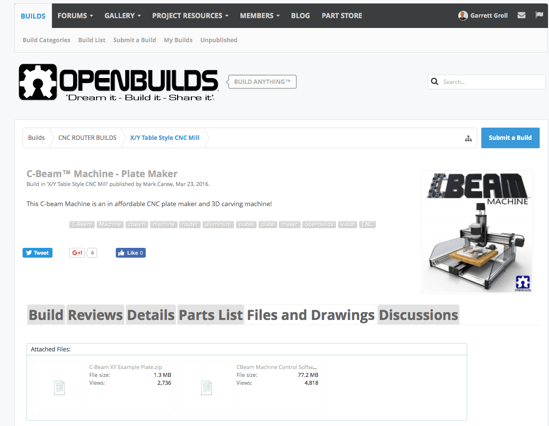

    Although I am puzzled about the need to install .Net 3.5. I build against 4.5.2??? Puzzle for me to solve :)
    Ah, the latest version is Release V1.0.9.3 Fixes · gerritv/Grbl-Panel · GitHub, I think you are using an old release. I switched to 4.5 in Release 1.0.7.0
  3. Garrett Groll
    Aug 14, 2014
    54
    I downloaded the files found on the C-Beam Plate Maker build page, and just figured that was the most recent version.
    Is there really any major reason to download the latest version? Everything works fine right now, so I just don't want to mess anything up. What are the major changes from 1.0.3 to 1.0.7?

    Joe is mostly correct, I would add that you should look at the actual list of fixes and enhancements first though. Releases · gerritv/Grbl-Panel · GitHub shows the full list of releases and enhancements/fixes. Sooner or later you will need one of the items or fixes. Because you can install GrblPanel in any directory there is little to no risk of problems, you can switch back anytime.
    I assume that the instructions for C Beam tell you to set $10 = 31, otherwise some of the information sent back by Grbl will not display.
