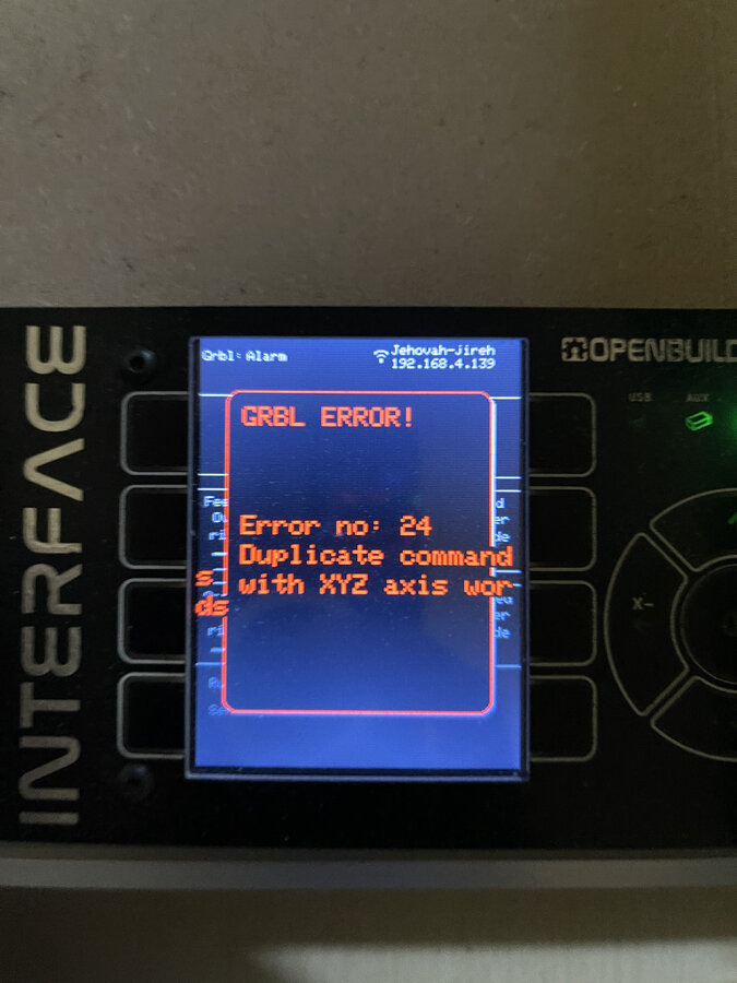

    I've not seen this error when using my laptop and I have run successful jobs with the interface. All of the sudden last night I got the error in the picture and the machine stops moving but the router and vacuum continue to run.
    I restarted the job 3 times and it stopped 2 times in the same spot. The 3rd restart the job goes farther but makes an unexpected cut in the job.
    I then ran an air carve and it made it past this point of the error.
    Using V-Carve Pro I recreated the GCODE and saved it directly to the USB drive to ensure my copy from disk to USB didn't corrupt the GCODE.
    I probed and set the XYZ and ran the job on the 4th attempt. It made it to the last cut in the job and I got this error again.
    Can someone help me understand what is going on please?

    Probably EMI related: See docs:blackbox:faq-emi [OpenBuilds Documentation] (Is your Dust hose grounded? if not, see the link for details)
    Worked through very similar yesterday: See INTERFACE CNC Touch Controller and downward - another user with similar issue, was EMI related
    Just make sure your firmware is up to date (v1.46 at the time of this reply): See docs:interface:firmware-update [OpenBuilds Documentation]
    But do submit the file, so we can try to replicate. ZIP the file, upload it to a reply, and we'll be happy to check it for you, run some tests on an Interface, etc

    I figured it out... EMI is my issue via my dust collection hose. I need to get anti-static hose or figure out how to ground it.

    Length of bare copper wire (available at the big box store, in the electrical isle, as bare earth wires for pulling into PVC conduit) - ran down the full length of hose(inside the hose / or wrapped around the outside)
    Attach the side nearest the vacuum cleaner body to a suitable Earthing / Ground point (not DC GND)

    Thank you for the videos. I took the time to run a piece of bare wire down the inside of my 2.5" dust hose and ground it at the vacuum side to a solid ground. I ran a test carve and I landed on the error again.

    I have grounded my dust collection to earth ground. I errand the cable for the Interface so it lay on no other electronics. I attempted to carve and I got the error again.
    i just successfully ran an air carve. What are the next steps please? I need this resolved or we’ll have to think about this differently.

    Just keep at it. Is your spindle Earthed? If not, adding an earth to its body may help

    I extended the ground wire and wrapped it round the body of the router and that worked.
