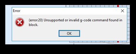

    When I send I get this message.
    System starts and runs normal even without clearing above message.

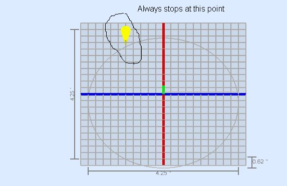

    When I get to this point (shown below) UGS stops sending code. If I click SEND again code sending resumes. If I do a double pass the second pass goes without a problem.
    Below is text from Console window. Lock up point is indicated.

    (error:20) Unsupported or invalid g-code command found in block.(error:20) Unsupported or invalid g-code command found in block.

    LOCKS AT THIS POINT
    click SEND
    **** Resuming file transfer. ****

    GRBL does not support tool change codes, so just remove the T0 M6 line.
    It also does not support the G64 command, so remove that too.
    all those 'skipping command' lines are worrying.
    the only things in that program that needs to be skipped is the Tx M6 toolchange command and the G64.

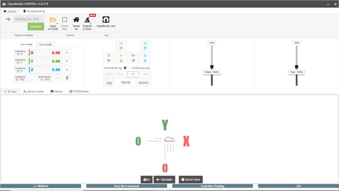

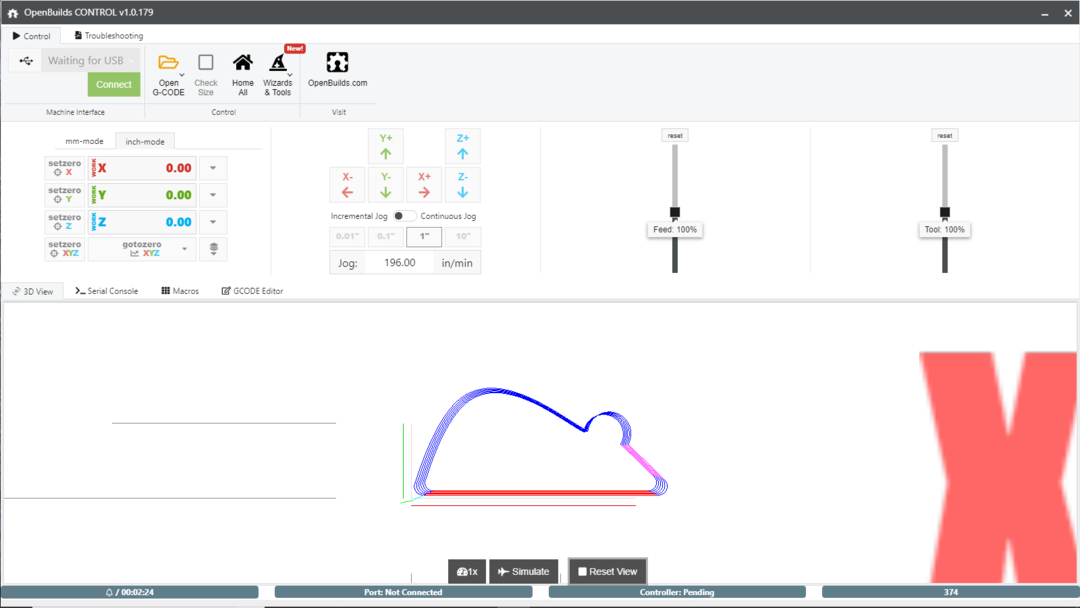

    Hi all, I seem to have the same issue, sort of. I got my machine (C-beam XL) working with my new BlackBox, limit switches homing works great, thanks for the help, when I try to run a job (my gcode is generally from Makercam so the files are .nc) gives me this error. (error:20) Unsupported or invalid g-code command found in block.
    I tried the file(s) (which worked fine before the BB upgrade) in both UGS and Open Builds Control with the same error code. Interesting the file works fine in Easel.
    I was using Arduino Uno/ Cshield before and the files all worked good.
    Any insight would be really appreciated!
    Thanks!

  14. sharmstr
    2,036
    1,433
    Its the Tool change line. Remove T0 M6. That was mentioned above as a solution to the OP problem too. G Code Errors LOL. Also, I edited your gcode post. I asked that you attach a text file so you wouldnt post the gcode in the thread. Sorry I wasnt clear about that. Ooops. LOL.
  15. crnrstndes
    crnrstndes Well-Known
    Jul 18, 2015
    68
    30
    Thanks Shawn, That is what I thought needed to be done. I suspect every one of my .nc files will need to be changed! OB Cam is a little quirky, not as intuitive as UGS moving vectors around and zooming so I prefer UGS.

  23. crnrstndes
    Jul 18, 2015
    68
    30
    The mouse is about 3" long and won't simulate properly.
    Zoomed way out!
  24. Peter Van Der Walt
    14,032
    4,119
    Post the gcode then :) same rule, need the file of the thing that causes issues to see why it does, otherwise guesswork is all I can offer
