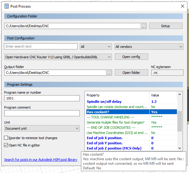

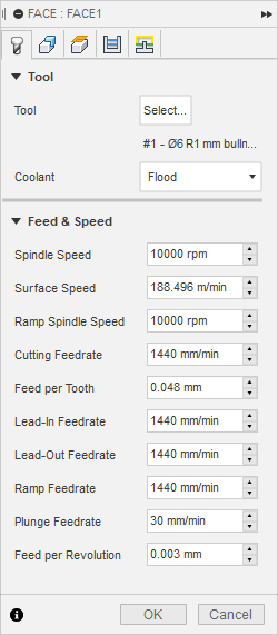

  12. David the swarfer
    3,287
    1,837
    Yes, it always outputs M3/M5 commands for spindle control.
    If you tick 'flood' for the tool coolant, and turn on 'has coolant' it will also output M8/M9 for coolant on/off.
    Here is the tool selection
    Here is the post setting
    And here is the resulting Gcode , spindle on in blue and coolant on in red (oh dear, the editor lets me set colours in the code block, but it is not displayed in colour so I have inserted comments after ';' characters so just search for those

  13. baum
    baum New
    Nov 26, 2018
    55
    If i got you correct all i need to do is hook the iot up according to the black box documentation and im good to go?
  14. Peter Van Der Walt
    14,038
    4,123
    Default grbl $30/$31 settings are 0-1000 "rpm". 10,000 will; still turn the relay fully on, but just a note that needs a check
