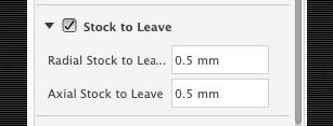

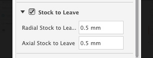

    So recently Ive slowly been making my way from Eseal to F-360. The other day I ran my first project using F-360 and I went through all the steps. Homing, setting the hight. But when it started it didn't lower all the way down to the pice it was, it was about 1mm shy. Any Ideas why. I cant find a reason for this. In Eseal I set the hight zero the Axis. and it off and running. Every time ive tried F-360 I set the hight zero the Axis, and it about 1mm hight from the project.

    Wouldn't affect the wcs Z zero - would offset X and Y and stop 0.5 mm before reaching the full Z depth.
