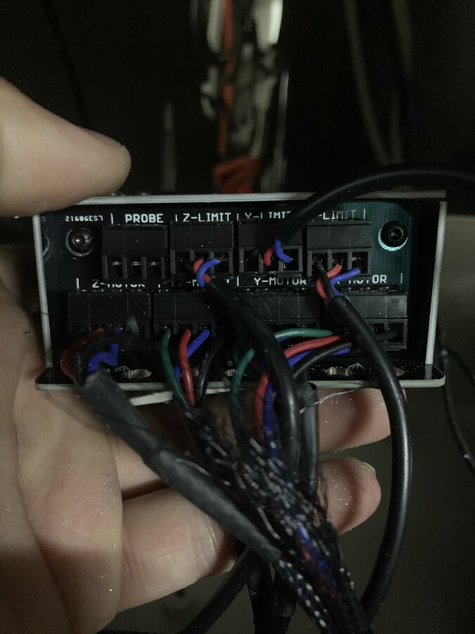

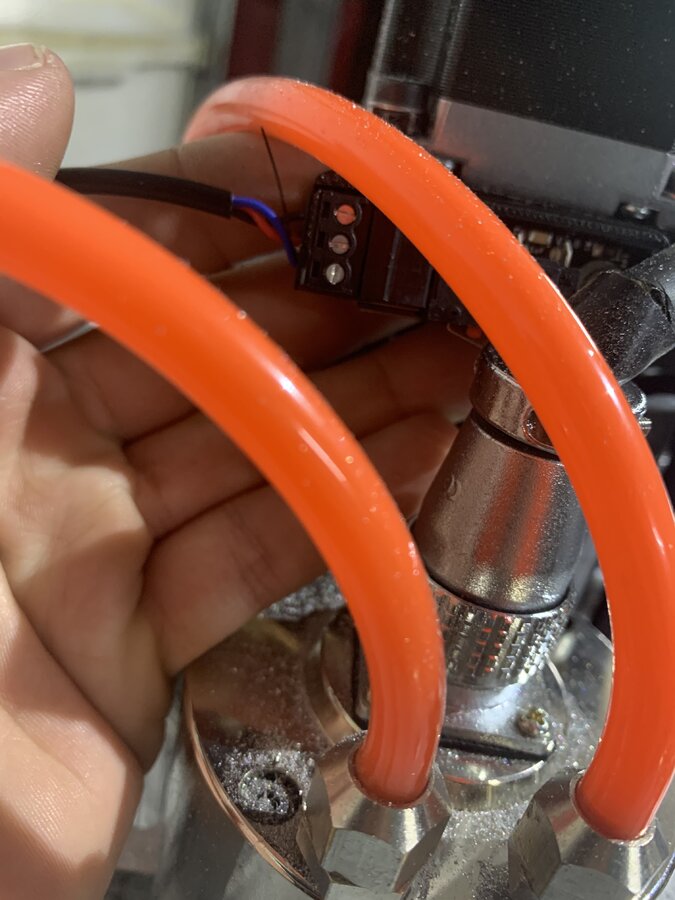

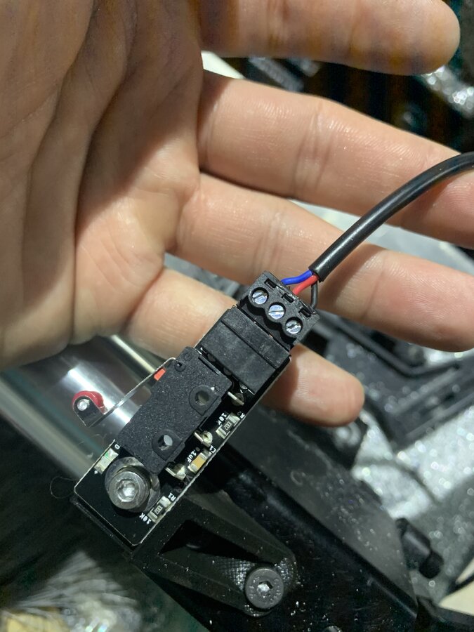

    im using the xtension limit switch kit and i checked the wiring. all the switches look and function correctly.
    When i crash the machine, my computer shut off and stopped working. This has happened twice.
    What do i need to do to stop usb surges?
    i dont really want to throw another computer at it till i know its fixed

    Sounds like a terrible miswiring somewhere. Take pics of everything.
  3. Matt Mahoney
    May 24, 2021
    It’s pretty simple wiring, idk what could be messed up.

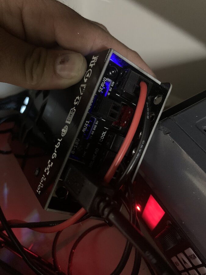

    The red and black provide 24v, the two black go to the vfd 10v
    14,036
    4,122
    Yeah nothing pops our immediately obvious. Isolate the VFD from the setup and see if the same happens, in case its backfeeding?
  5. Matt Mahoney
    May 24, 2021
    isolate the vfd? how would i go about doing that?
    See if the same happens? purposely crash my machine with a laptop connected and see if it crashes it? lol
    the computer stopping working is permanent, i can no longer turn them both on. so i would rather not play the guessing game with computers o_O
    14,036
    4,122
    Unplug it entirely. Mains and control cabling. Take it out the picture (as a third party component, first suspect)
    Cheap USB hub in between... USB ports are well protected, so can't imagine what goes wrong to actually kill it
