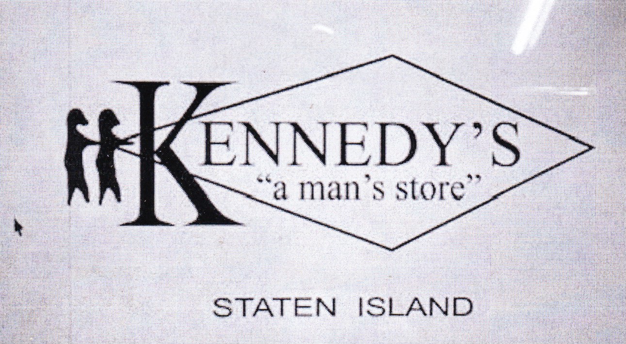

    The sign has letters about 1/2" high. The sign will be on oak board. Are there single-line fonts similar to Times-Roman font?

    This is the sign that I'm trying to create for someome. The small letters are about 1/2 inches.

    V Carving would be best. Try Vectric

    I would just import the image into Sketchup and draw around it, that pixelation is going to defeat any automated conversion to vector format.

    I already draw around the lines and two persons. I entered text. The lines, persons, and the big "K" are OK using 1/8" bit. The text won't appear unless I use 1/16" bit and I don't want to break 1/16" bits.

    A V bit would be best using Vectric's Vcarve that you mentioned you have.

    Someone drove me crazy creating the sign but I was able to cut the sign on the machine.
