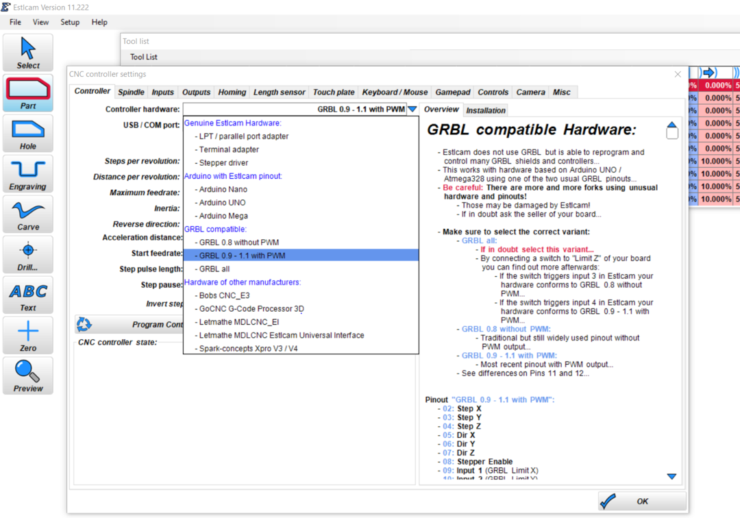

    Not wishing to 'brick' my superb Black Box, can you confirm which setup from Estlcam I should be flashing the Black Box with? Gary seems to say that he uses an Xpro for his setup - whereas I would have thought that I should be using something more in line with a Uno R3 based setup. It certainly seems that way to me as this is what is recommended when I load the estlcam software (see attached screenshot file).
    Just trying to make sure that I get no nasty surprises if and when I go down this route to see which I prefer.... Would be even better to know if all the pin assignments (shown in my screengrab attached) are in fact correct for the Black Box?
    Thanks to all - Willow52

    The BlackBox is an Uno compatible (in terms of bootloader and chip config)
    It's pinout is offical Grbl pinout: gnea/grbl

    I used the Xpro config on mine and have had no issues with pin-outs, limits or spindle for example work correctly. Uno probably fine as well, I don't think it would matter.
    Yes the backup restore works too, I tested it.

    Uno = ATmega328P
    xPro = ATmega328PB
    They have different signatures, slightly different peripherals

    Hi Duncan, Yes you can keep the same workflow, only need to flash the firmware if you wish to use the Estlcam controller. (Which I have using the X-pro preset)

    Hi Gary,
    Have just now finished building a Shapeoko 2 clone (which I am very pleased with) and have successfully controlled it using my Black Box controller. I'm now looking to see if I can hook it up successfully to EstlCam v10.
    I did take note of your earlier comments that the the way to go was to set it up as an XPPro. However, I can't seem to find that option anywhere - the only controllers avaiable in my version 10 seem to be Shapeoko 3 and Stepcraft. Also, grbl 1.1 seems to be unavailable as well, so I'm a bit stumped as to where to go next.
    Hope you can give me one or two pointers as to where I should actually be looking to find the XPPro dropdown?

    OK Gary, got it now, many thanks....

    The Xpro is here below. But wouldn't Grbl 0.9-1.1 be a possible choice?

    Grbl preset would probably work just fine, but I just did mine over last weekend as I replaced my pc and xpro preset worked again perfectly. Tested coolant, spindle control, limits and probe.
    I think it was Christian who recommended using xpro a while back when BB came out.
