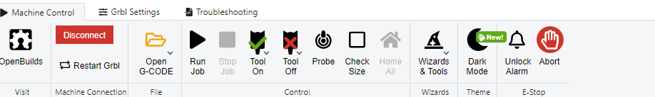

    Thanks for the response but now I have a different problem. Now my home all button is not lit so I can't home my machine. It seems every time I turn my router on I get a different problem. Screenshot 2023-01-26 165619.png

    Did you turn Hard limits back on? I believe you need that for homing
  8. Peter Van Der Walt
    13,986
    4,106
    Grbl Settings tab > Turn Homing Cycle back on
