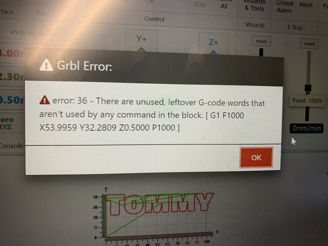

  9. TommyTT
    TommyTT New
    Feb 2, 2021
    2C3B0EC6-67EF-4172-97D1-1E316D19C9DF.jpeg This comes up in controls will not let me get passed the initial touch off ? Any help would be appreciated
  10. Peter Van Der Walt
    14,038
    4,122
    P1000 at the end of the line does not belong in a G1 command. This is not Grbl compatible Gcode. Use a Grbl compatible cam/post.
    sharmstr and David the swarfer like this.
  11. TommyTT
    TommyTT New
    Feb 2, 2021
    we’re do I delete this ?
  12. sharmstr
    2,039
    1,434
    Click on the gcode editor tab and delete it from the code listed.
    However, you'll probably have more issues since its not grbl compatible gcode. As Peter said, find a grbl compatible post processor for whatever software you are using for CAM
  13. TommyTT
    TommyTT New
    Feb 2, 2021
    I created the g code with open builds software so confused ?

  15. David the swarfer
    3,287
    1,837
    I think it is USB corruption, it has missed the linefeed and G4 that would precede a P1000
  16. Larry Paige
    Dec 18, 2017
    13
    Has anyone solved this? I have the same problem except mine read L1000 on every line upload_2021-12-2_19-54-13.png
  17. sharmstr
    2,039
    1,434
    You need to use a valid grbl post processor. L1000 isnt a valid command.
  18. Larry Paige
    Dec 18, 2017
    13
    Okay thanks, but I am using all openbuilds stuff. Blackbox and the online CAM. Am I missing something???
    Openbuilds CAM.
    Instead of "transfer code to Openbuilds" I should save the code and use a different code processor?
    I got it going. So, in your OG post you had P1000 and I had L1000. In OB CAM, As you probably know, the P=plasma the L=laser and S=spindle speed. Below that setting there's a power/speed scale and that contains the number that follows our L/P1000. Adjust those properly and your good! I set mine to S (Spindle) and 0 (Speed).
    So, the Power/Scale is looking for an input of RPM from whatever tool you are using or perhaps laser intensity? IDK. But it makes sense or at least 2 cents.:)

  19. Larry Paige
    Dec 18, 2017
    13
    Okay, so I guess by messing around with that, I started the error 36 AND by messing with it some more, I fixed it!
  20. Peter Van Der Walt
    14,038
    4,122
    No! Grbl uses S for everything. Don't change those backend configs please - not relative to you (only for people using other controllers/firmwares - defaults are of course all set up for our stuff)
    Read here Grbl v1.1 Laser Mode · gnea/grbl Wiki to understand Grbl's laser mode
    Then after that, read the Entire Grbl Wiki - its a goldmine
