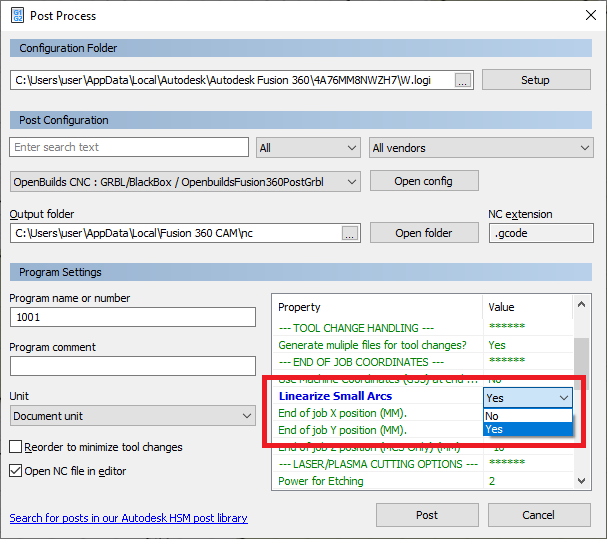

    OK, never had this issue..
    Zero-ing to center (because it's a round item, and helps me keep tool paths aligned)
    • Openbuilds Blackbox, all up to date
    • Fusion360 for model/tool paths
    Adaptive clearing- everything's fine.
    Parallel Tool Path- ECK! starts from Zero but dives down and direct to start location.!! No rise- move to start point like others. Not sure if it's something in Fusion or some button I can't find (I looked, I looked a lot!)
    Does it at the end also!!
    Isn't there a "Start & End" G-code script or something that should prevent this?
    Coming from 3D Printing, all the slicers have a start code that is auto attached to all code generated to prevent this kinda thing.,....
    What am I missing?
    Image and parallel's g-code uploaded if that helps
    Thanks!

    OK, stopped at the exact same point in the cut- "error 33 Invalid Motion Target" what ever the hell that means..
    OK, I get it's an arc error, but how to fix? been googling now and the issue comes up, but no one seems to have a fix..?

  14. David the swarfer
    3,430
    1,907
    you have the fix (-: , there is an option in the fusion post for linearizing small arcs.... turn it on and regenerate your gcode.
    The issue is that fusion automatically calculates some arcs from the bit diameter (entry and exit arcs), and if the bit is small the arcs are even smaller and then fusion generates tiny arcs with slightly different radiusii, different enough for GRBL to flag an error..
    Thomas Lamourine likes this.

    I don't see it! where? what setting?
  16. Peter Van Der Walt

  17. Thomas Lamourine
    May 6, 2017
    42
    14

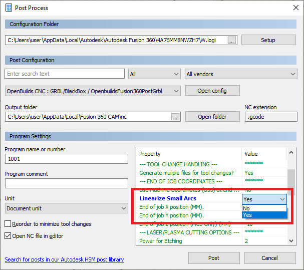

    OK, Fusion looks NOTHING like that on my computer- but guessing in the Post Processing - this thing? I'll give it a try.. thanks. :p

    OK, ticked it on.. running it without spindle or vac on,.. cuz.. NOISE!! LOL. (yes, I took the bit out)
    stupid question..... shouldn't it be on by default?
    anything else you guys see off hand in that list I should have on/off/change for default settings?
