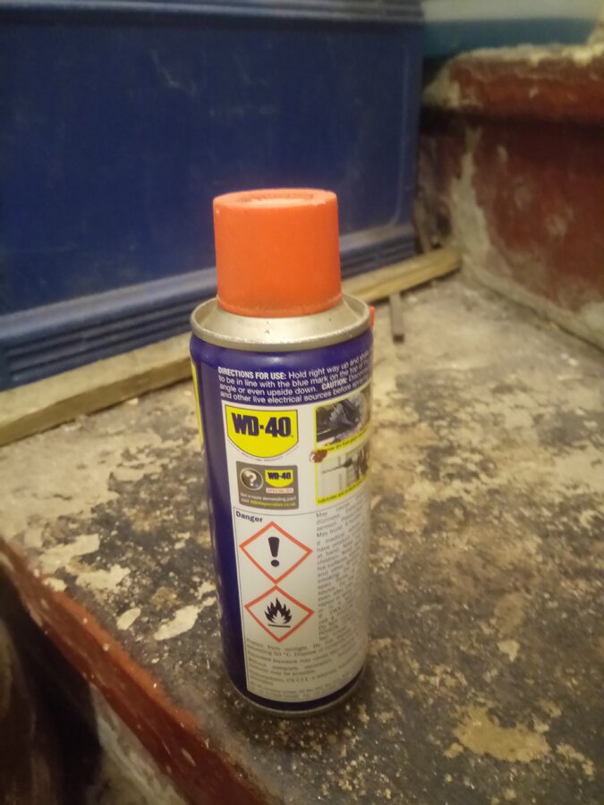

    Has anyone built their desktop cnc with a drain pan below? I cut mostly aluminum and i have to actually stand there while I cut everything so i can spray wd40 as the spindle is cutting. The aluminum gets really hot and at times you can hear the spindle sound like it wants to stall. then I have to spray wd40 to keep it going.

    Also (and sometimes more important) - make sure you are using the right bits! Uncoated bits literally weld aluminum chips into the flutes. Using proper coated bits (CNC Router Bits - OpenBuilds Part Store for example) makes the world of difference with this. I've not had the WD40 at hand in a while (;

    Hmm, I use uncoatd bits for aluminium - cheap 3mm single flute, spiral upcut from Ebay. RoutER11 at 13K rpm, 0.5 mm doc/woc (I'm sure I could increase that), 2000 mm/min. That's on a workbee with linear rails upgrade, with V wheels feedrate was much reduced. I found I needed coolant with the wheeled workbee (alcohol - not WD40 - I found that caused the chips to clump around the cutting area), with linear rails I don't use coolant at all - the downdraft from the RoutER11 is enough to keep the area clear of chips (which take most of the heat generated with them).

    Alex, appreciate this info. This is very interesting as I do not like using the wd40 since it gets the entire work area oily and the chips do clump up in the cutting areas, looks like I will have to try the alcohol to see what happens. My build is all linear rails as I don't like the wheels, seems there is a lot of drag when it comes to the wheels.

    Alcohol based coolants have flame retardant in it, don't go out and just use regular alcohol, which can have a low flash point. That is just a fire waiting to happen.. especially if the vapors/mist somehow get drawn into the spindle....

    WD40 is also inflammable - I find a blast of air is an adequate coolant now (and safer)

    Yeah, I don't use wd40 either, or anything with a propellent that is flammable (what makes WD40 so explosive). I have this aversion to bursting into flames
