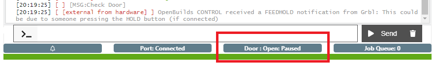

    CONTROL bug fixed: V1.0.276 will be available in a couple minutes via online update or software.openbuilds.com
    - Note GRBL will not automatically resume the job when you close the door - it is a safety feature. It only allows the software, to send the Resume command - so after closing the Door, you have to click RESUME in CONTROL as well. This extra check is to involve the human in ensuring the door did not just swing closed by itself or you forgot a wrench on the stock for example.
    - v1.0.276 also adds nice door statuses in the bottom status bar:

    Alright so I hooked the BB up to my machine and I've flashed over the hex file you provided. Everything works as far as (close the door contacts) job PAUSES and TOOL turns off and won't resume until I (open the door contacts) and physically press resume. The only thing it's NOT doing is raising and parking Z at -10mm from the original homed location if I'm wording that correctly. It actually doesn't raise Z at all. Just turns the spindle (tool) off and stays right where it's at. And when I hit resume it actually IMMEDIATELY continues the job to the point where the spindle even set at 1 second acceleration would probably cause an issue. But that's only because the Z axis hasn't raised up out of the way in order for the spindle to have time to ramp up.
