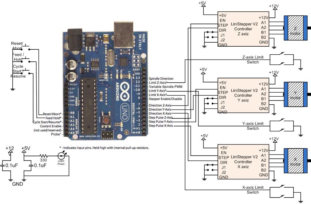

    Am trying to setup my CBeam after a break. But I lost the installation diagram files due to a system crash. Does anyone have a wiring schematic handy? Thanks.

    Ah, let me explain. I took apart my cbeam when I moved. Managed to find a location in the new place. However I disassembled the hookups to the Arduino board and forgot which wire goes where. I filed it away but the file got corrupted when I had a BSOD.
    I just need a guide as to where the wires are to be plugged in. Thanks.

    Are you using a shield, or wiring directly to an Uno. Here is a basic diagram I found if directly, more than likely not the exact same, but will give you an idea. If you are using a shield, find the documentation for that shield.

    Am wiring directly to the Uno. Gonna slowly work around it. Fingers crossed.
