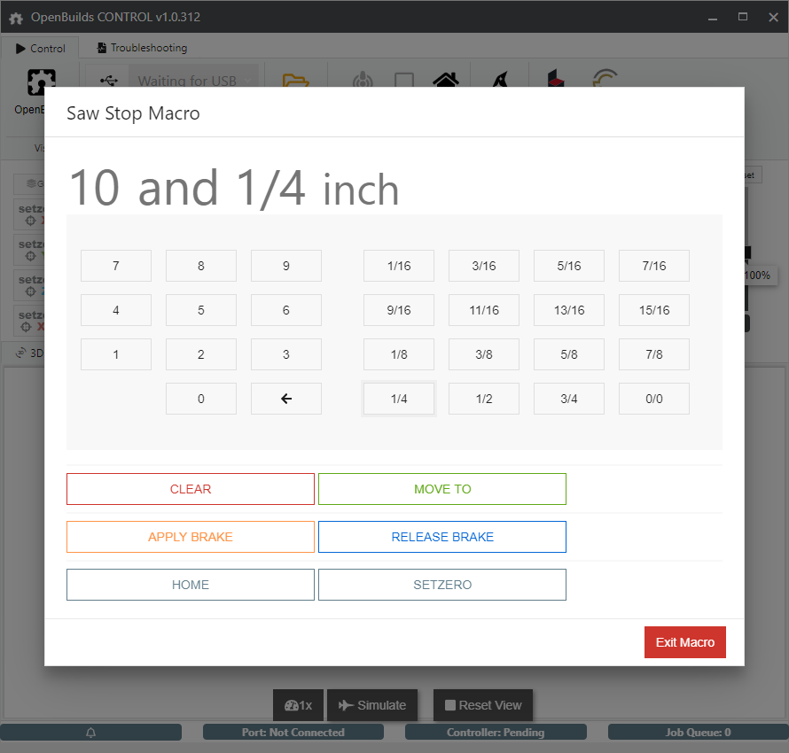

    Hi guys I am new in this forum. Greeting everyone. We have a cutting machine and I want to build a positioning stopper. I am planning to use V-slot actuator belt driven system. I have never worked with cnc controller so I am thinking buy a delta plc and servo for it. With a hmi screen i hope it will be better. I will run it sometimes with a file that included part length already. So it can go to positions automatically. I want it to print labels too. The working length will be 3500-3700 mm. So as I can understand I need to buy 2 two extrusion and connect them.
    Application examples:
    https://youtube.com/shorts/HuuvSMIpB5U?si=3QDFn6fYKvxWDskP
    Questions
    What can i use in Openbuilds store instead of delta plc and servo?
    Would Openbuilds belts be sufficient for this application? Should I pick 20mm width belts?

    I used to work as a test engineer in an automation company. We were using Beckhoff plc. I was testing machines,checking codes and giving feedback to the R&D. We were using plc, driver, pc, power supplies.It was a long time ago I am rusty and I am not familiar with arduino or raspberry pi but i will do my best with your help. I have a plc programmer friend I will invite him to this forum too. Now I am making a part list I hope you can help me.
    (1)BlackBox Motion Control System X32
    (3)Xtension Limit Switch Kit
    (1)24V Meanwell Power Supply Bundle
    (1)Xtension Wire Set - 4 Conductor
    (1)Xtension Wire Set - 3 Conductor
    (1)Raspberry Pi (Or a pc)
    (1)10" Touch Screen compatible with Raspberry Pi
    Can I use a NEMA23 with encoder from a different supplier? I don't want to deal with calibration every time? As I understand I don't need to buy motor driver blackbox works for the same purpose. I checked the project you sent me that NickEng's Saw Stop. I have more budget so i'm more flexible. Even I can buy a servo. My other question is do you think I need an arduino?

    BlackBox does not support Encoders. However there is no "calibration every time" - calibration = correcting for mechanical tolerances - you can set steps per mm theoretically if the parts are good. Either way, once off. Not something you do "every time"
    Do make sure 3rd party motors meet ours' electrical specs. Ours are optimal for BlackBox (voltage and inductance too, not just current rating)
    Yes has 4x Onboard stepper drivers
    Not if you go X32 > CONTROL > Your customized Macro

    Peter I put everything in a word file. We will proceed to purchase parts next week. I checked this javascript code and I modified. It can work with a part list file. What I wanna know is can I adapt a label printer to this system. It already able to read csv variables. I want to add a part name and length information on a label. It can be a print button so I can press it every time cut finish. Do you think it is possible? Or what kind of help do i need?
  14. Peter Van Der Walt
    14,701
    4,249
    Should be yes. Build the label with a little css and html (created dynamically from the js macro) , use window.Print to print it
