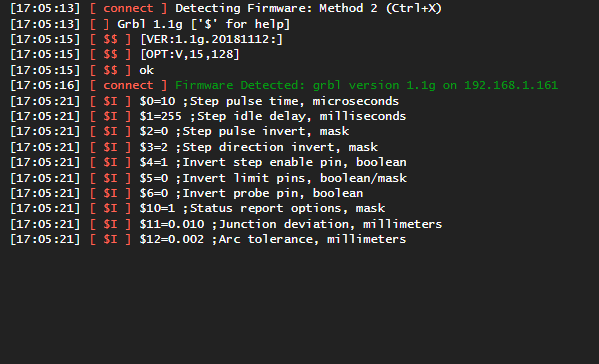

    Latest Control decided to stop showing all Grbl settings:

    I tried all this. I also put a esp-link between the two to sniff the data and the BB is indeed sending all the settings. The app is not showing all. It started randomly, days after the upgrade. I have had the latest Control since it was released.

    Grbl 1.1g but over an IP? Green line of the log screenshot. Doesn't look like standard set up? Attempt at a diy wifi bridge? Queue is confused too ($xx=?? Responses, But queue thinks its in response to $I command ) which may be explained if some device sits between CONTROL and Grbl? If the bridge decreases the buffer, or strips newlines it would affect it as well
    Telnet connection is for GrblHAL on the new X32

    Yes, this screenshot was taken with an esp-link between the two. This way I can sniff the traffic out of grbl easily. I have used the CNC with that configuration without any issues.
