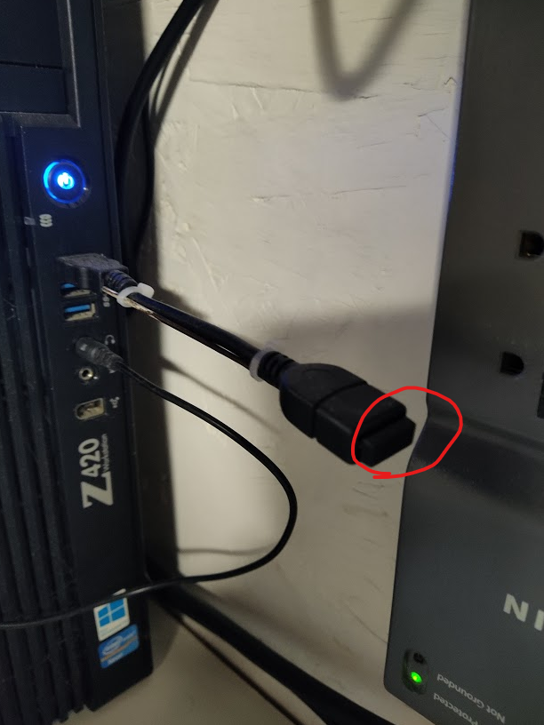

  25. brrian
    brrian Well-Known
    Dec 6, 2019
    118
    51
    I had wireless mice & keyboard issues for a while... either the mouse/keys wouldn't work, or they'd work, then stick, and it was because of some sort of electrical interference with the wireless dongle. I solved it by plugging a 6" USB extension into the computer, then the dongle into the extension. I haven't had a single issue since then. Likely not related, but mentioning just in case...
