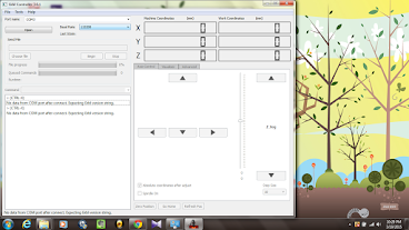

    See i cannot even put in a command. It will not allow me to do anything.

    I see. What are you using to connect to send GRBL to the board?
    It looks like more a connection problem than a configuration. I suppose your com4 port is the right one.
    Is the board getting properly connected?
    I had a problem in getting connected the board, solved connecting the USB before powering up the board.
    ps:Sorry for silly questions, just writing whatever is coming in my mind to try figure out any possible reason.

    I am using the usb cable. My com4 port. It connects to the board. And then immediately under the command line the CTRL-X appears and then a sentence or two that i dont understand.

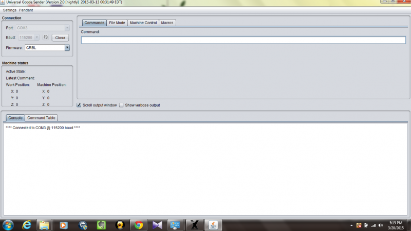

    I have the exact same problem, does anyone here has some suggestions ?
    Appears right at start,
    cannot put in any command,
    nothing machined yet (so no debris at connections)
  17. John Meikrantz
    John Meikrantz Well-Known
    Nov 2, 2014
    169
    56
    What does the text say? It is too small to read in the posted image.

    John, thank you so much for your quick reply. I am going to try this solution as soon as I am home, I am going to keep you updated.
    BTW: I am using the Xpro V2 with GRBL 0.8
  22. John Meikrantz
    Nov 2, 2014
    169
    56
    Ah, if you are using GRBL 0.8 you need to set baud rate to 9600, not 115200. I would highly recommend updating to 0.9, however. It really added a number of nice enhancements.

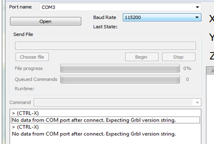

    John, sorry, my bad, I have checked, it's a 0.9 version GRBL
  24. Bernd
    Bernd New
    Mar 3, 2015
    24
    and now, all it says at start up is:
  25. John Meikrantz
    Nov 2, 2014
    169
    56
    What happens if you just send a $$ command? Sometimes mine needs to be prompted with input. I either send a $$ or from the machine control tab send a soft reset.
  26. Bernd
    Bernd New
    Mar 3, 2015
    24
    Thanks for the reply....yepp that's the problem, nothing happens, I can send whatever....
  27. John Meikrantz
    Nov 2, 2014
    169
    56
    Silly question, but are you sure it's the correct serial port? Maybe try downloading the latest FTDI drivers - http://www.ftdichip.com/Drivers/VCP.htm

    Oh no, absolutely not a silly question, but i have already re-installed 3 times. No success....
  29. John Meikrantz
    Nov 2, 2014
    169
    56
    I'm at a loss, then.
    Do you have an Arduino IDE installed, so you can try just some basic serial terminal communication via the serial monitor?
    Maybe try sending a message to Michael, who started this thread. He is one of the creators of the xPRO.
  30. Bernd
    Bernd New
    Mar 3, 2015
    24
    Thank you so much for the help. I am lost here too.....I have contacted already Spark concepts from where I have purchased the board. I am at the point where I assume that it is a hardware issue.
